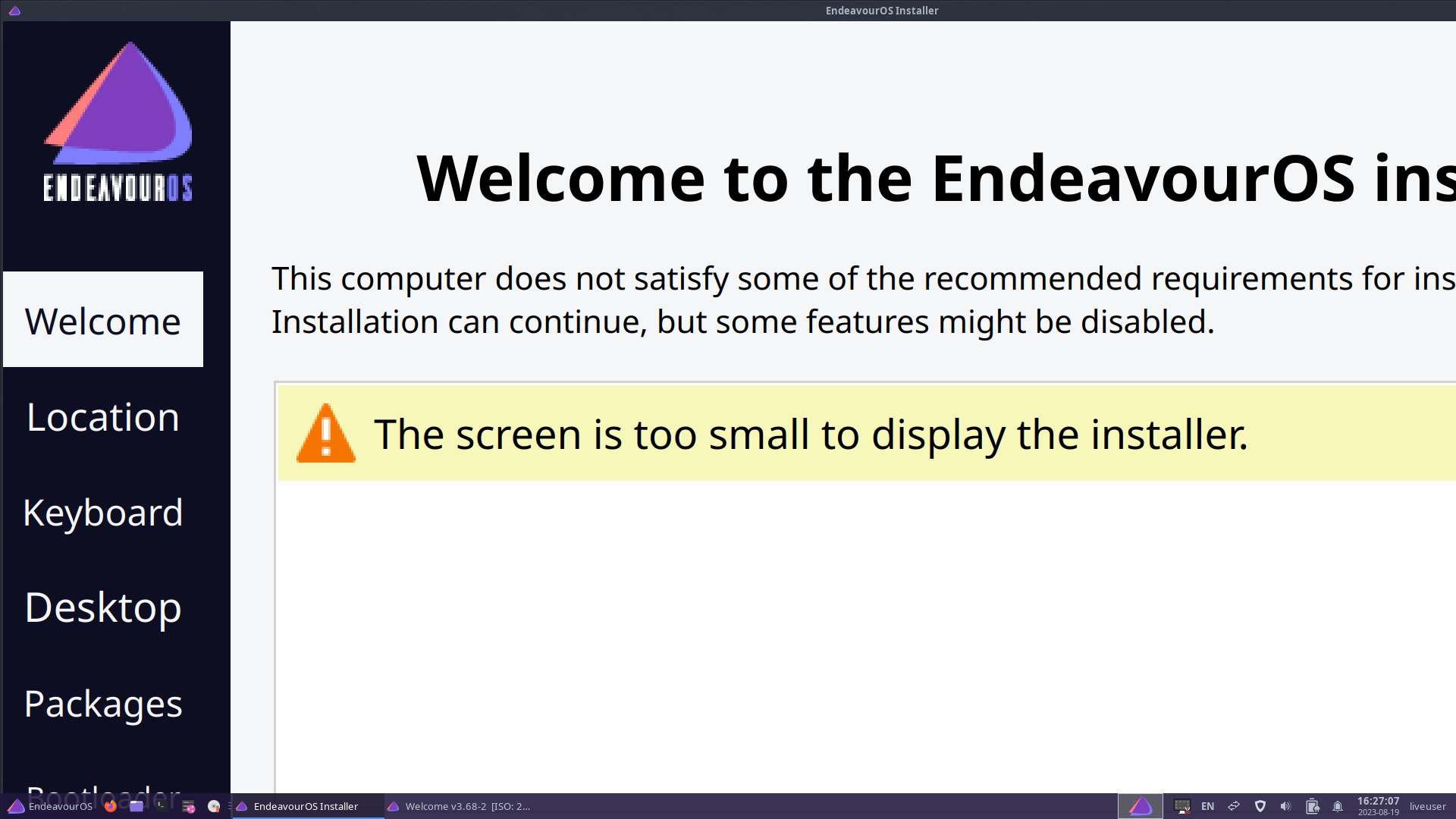

I’m trying to install EOS on an old PC that I’ve previously been using as an HTPC. It’s been working perfectly well with an old Nvidia card (GT 9600) that kind of worked but it was too old to get drivers working properly for hardware acceleration so it would decode on the CPU rather than the GPU. Today I got an Nvidia GT 1030, put it in and booted from a Ventoy flash drive with the option to use Nvidia drivers. This GPU is supported by the newer drivers. Everything looked perfectly normal until I clicked on the installer, then ‘Online’.
The enormous installer displays: “The screen is too small to display the installer.”
It’s worth noting that this is on a 46 inch TV running at 1920x1080. So… Not small.

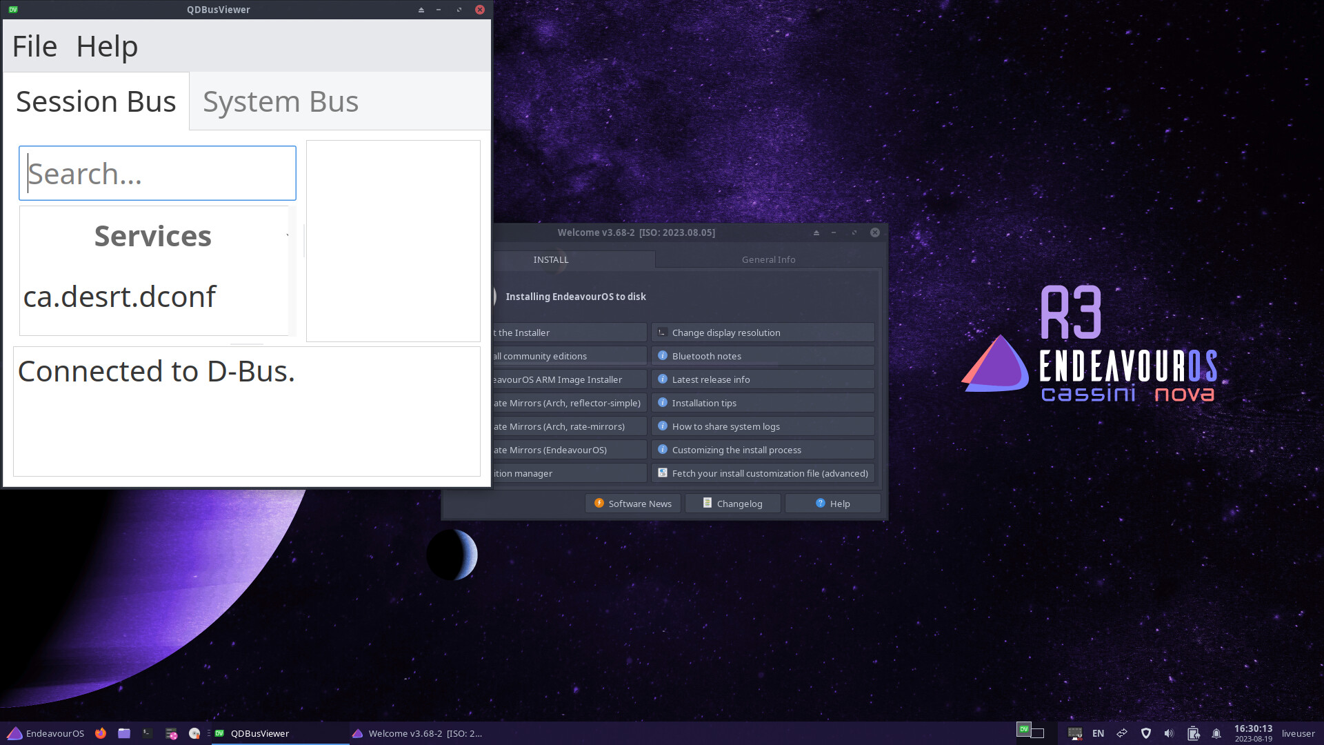

Then I decided to see if any other software has any similar problems. When I went into the launcher and Development->Qt (anything) the problem occurs.
The short version is: Anything Qt based will display with comically enormous proportions when the Nvidia option is selected at boot.

Notice how the Nvidia log says:
Available desktop QSize(640, 349) minimum size QSize(800, 520)
… Proposed window size: 800 520
and:
requirement 6 “screen” satisfied? false mandatory? false

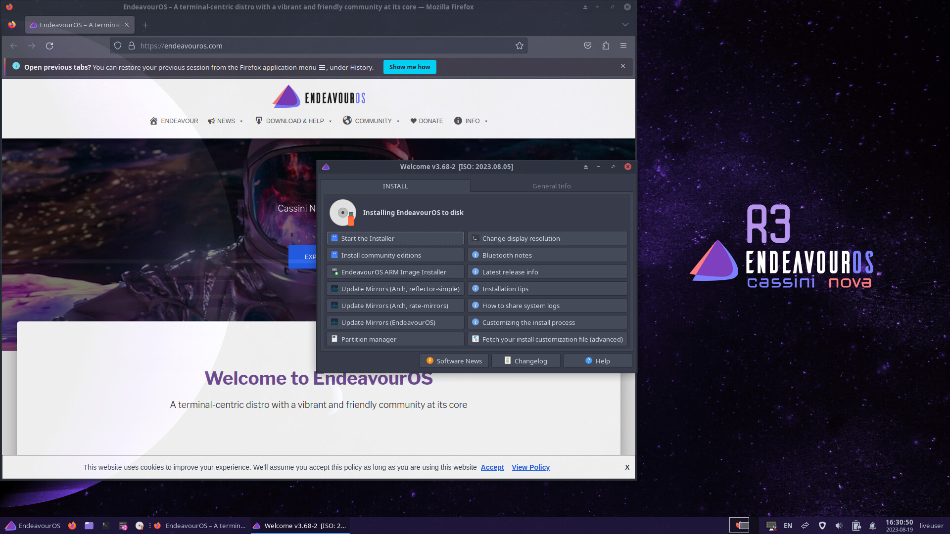

Screenshots of the attempted Nvidia install with shots of Qt applications to show the problem. I also include Firefox to show it’s unaffected:
