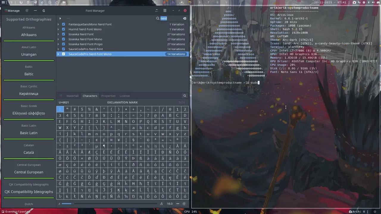

The video below is about polybar, but the workflow/fix is pretty much the same.
