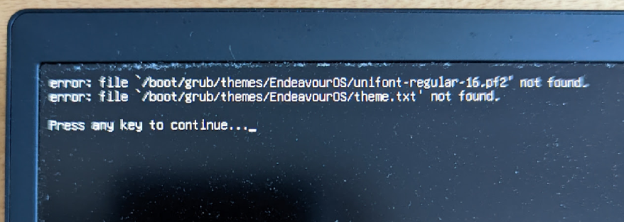

I am having the exact same issue as OP. I am also able to boot normally after pressing any key.
cat /etc/default/grub shows this:

Few days ago someone suggested to comment out the THEME section because some EnOS package got removed from repos.
Did you run sudo grub-mkconfig -o /boot/grub/grub.cfg after that?
You have to edit /etc/default/grub and then run sudo grub-mkconfig -o /boot/grub/grub.cfg
I am pretty sure that I did. Will do it again, and see if it helps.
@dalto that was the fix I guess :slight_smile: Thanks
so you were lucky :wink:
i did not run
so i have to reinstall grub in chroot . but i surely learned from that mistake :upside_down_face:
I mean I didn’t run it few days ago, and got the error from above only today. But I was able to boot normally every time after clicking the error away.
Running sudo grub-mkconfig -o /boot/grub/grub.cfg made the error go away :slight_smile:

Yes I just miss the wallpaper at the back ground and for science I want to know how to get it back haha
So it looks like you have removed the lines related to EnOS Grub theme from /etc/default/grub.
If you want to get rid of the error messages at boot, most probably
should help.
If you want to get the theming back:
Please click on here or here in the box above.
If you install the theming package again, You would need to add back the lines you deleted in /etc/default/gub and regenerate grub.cfg.
The theme has been removed from the repos but you can easily set a wallpaper with the wallpaper with
GRUB_BACKGROUND="/usr/share/endeavouros/splash.png"
That is our standard grub wallpaper.
There should be no need to chroot when changing a wallpaper or grub theme.

I got it back!!! legendary no needed to get to the chroot!
Glad you got it back and dont need to reinstall grub with chroot. In my case i couldnt boot so i need to chroot. In the end we are all happy :enos_flag:
