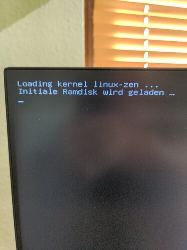

my pc is not booting today.
I noticed that two data are missing from the grub:
/boot/grub/themes/EndeavourOS/unifont-regular-16.pf2
and
/boot/grub/themes/EndeavourOS/theme.txt
after that it goes to the menu from where i can select the kernel.
no matter which kernel i select after
loading kernel linux-lts
initial ramdisk is loaded
this is where it stucks
nothing works anymore

Since grub menu is functional, your issue (boot failure) is not related to grub theme.
Nevertheless, can you explain how did you notice this?:
You might want to try a different kernel.
The posted image shows linux-zen, while you write linux-lts. What is the right one?

it comes immediately after booting before the boot screen shows up

why didnt my picture taken from my smartphone shown?

i have tried with each kernel on my system. lts, zen and normal one
