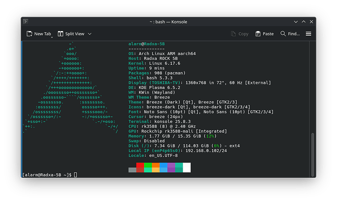

Typing this post with a freshly installed KDE Plasma on Radxa ROCK 5B.
More later.

If you want to install Archlinux ARM on a Radxa ROCK 5B onto a micro SD card, download
https://github.com/warpme/miniarch/releases/download/09930fc917cc/MiniArch-20240715-6.17.1-board-rk3588.rock5-b-SD-Image.img.xz
goto
and scroll down to Quick Start then Install (when You will stay with SD Card) :
Follow the instructions and you will end up with a working Archlinux ARM OS on a Radxa 5B on a micro SD card.
I have not figured out how to install this to the built in M.2 nvme port.
