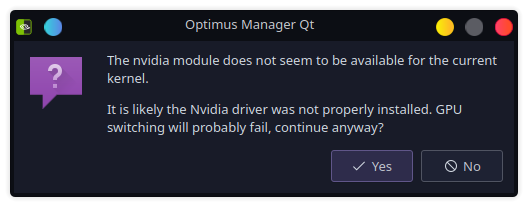

When I click it and select switch to Nvidia, it asks if I want to switch GPU. When I click Apply, this happens:
This is the link in the alert window.
I click Ok and this message shows up:
When I clicked Yes, it logged me out. I logged in and the tray icon is not present, even if I start the optimus manager app from app launcher.

optimus_manager.kernel.KernelSetupError: module nvidia is not available for current kernel. Is the corresponding package installed ?
[1146] INFO: Removing /etc/X11/xorg.conf.d/10-optimus-manager.conf (if present)
[1146] INFO: Writing state {'type': 'pre_xorg_start_failed', 'switch_id': '20230519T084346', 'requested_mode': 'nvidia'}
[frankieee@frantaspc ~]$
It still looks like Nvidia is not installed properly, but we did the nvidia-inst.
