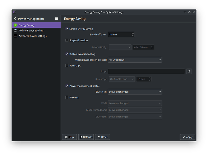

No it was already installed and enabled? :man_shrugging:
Edit: Maybe that’s only for laptop on battery?
Edit2: I think i found it?
Switch to:
What options do you have over there ?
It doesn’t seem to work but it has performance, balance and power save and leave unchanged.
Those are the 3 modes that power-profile-daemon can use.
It works, check with watch -n1 "grep \"^[c]pu MHz\" /proc/cpuinfo" , you will see that most of the cores will have very low frequencies.
If you change to balanced, compare with the previous values, it is very clear to see that the frequencies change by a lot
Maybe it works but the slider in the notification doesn’t change?
Edit: Looks the same to me.

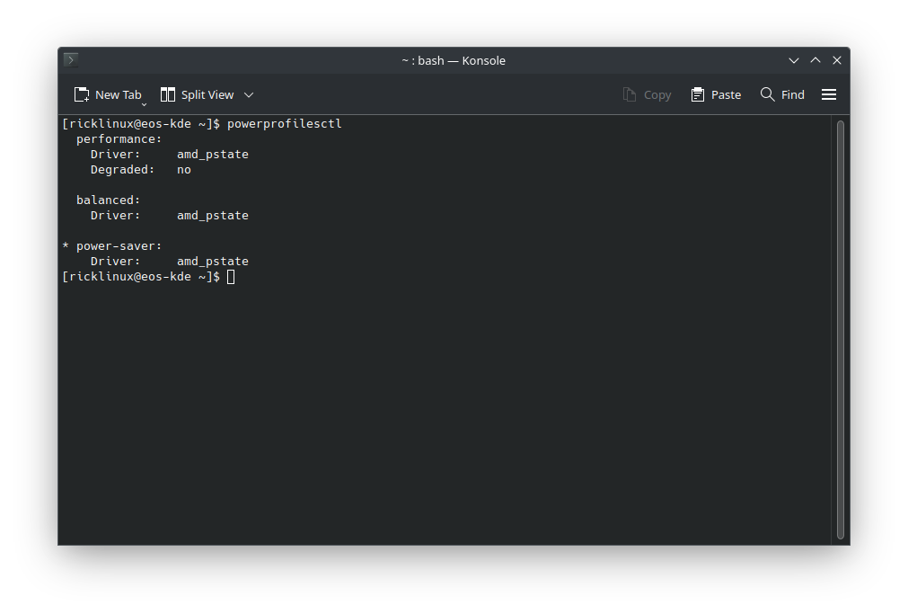

Maybe it’s already using powersave?
Edit: I won’t waste anymore of your time. This amd pstate stuff keeps changing anyway. I’ll just see where it goes. I’m also running ECO mode 65w anyway in Bios.
hmm, it seems to be. The * is pointing to the power-saver, so I suppose it is working…
