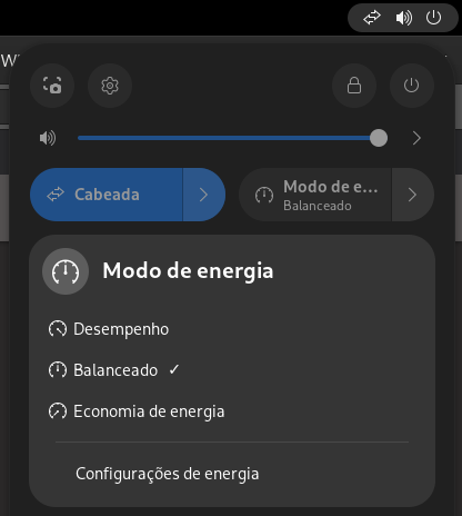

$ cat /sys/devices/system/cpu/cpu*/cpufreq/energy_performance_preference
balance_performance
If I change that option in the picture to performance, I get:
performance
And, if I change that setting to “Economia de energia” (power save in English), I get:
power
Edit: “Desempenho” means performance in English.

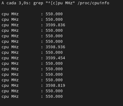

My turbo boost also shows Active: no
Strange, because it is enabled in BIOS, not sure if cpupower is wrong or if it is disabled indeed.
If I check through conky, it seems to be enabled, I can reach boost frequencies.
However, checking with the command below, the MAX I can get is 3600MHz..
watch -n1 “grep "[1]pu MHz" /proc/cpuinfo”
