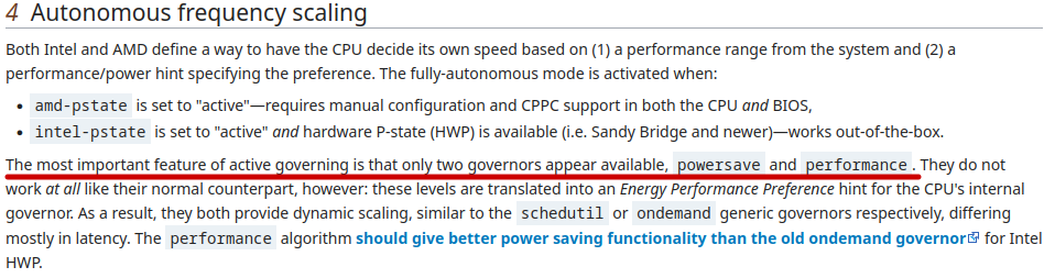

Images got from: https://wiki.archlinux.org/title/CPU_frequency_scaling#top-page
Previous versions of cpupower didn’t include these new governors from amd-pstate-epp driver.
Since you already have it updated, you don’t need to do anything, unless you want to change the governor from powersave to performance.
