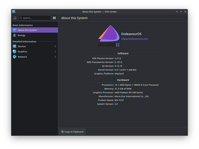

[ricklinux@eos-plasma ~]$ uname -a
Linux eos-plasma 6.4.1-arch1-1 #1 SMP PREEMPT_DYNAMIC Sat, 01 Jul 2023 16:17:21 +0000 x86_64 GNU/Linux
Edit: I am also running KDE on Wayland.

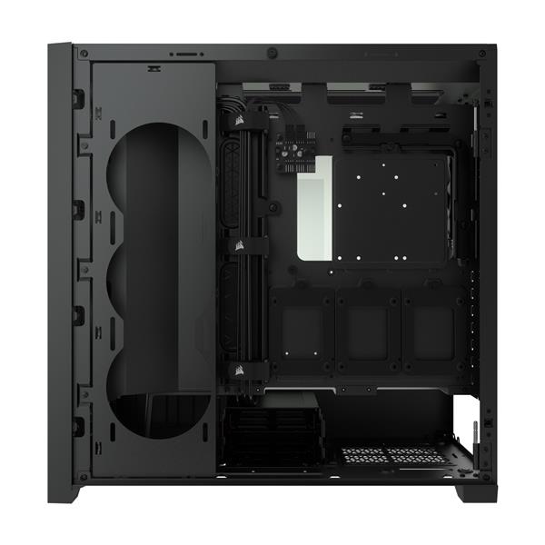

I still need m.2 drives and ram and power supply. I have everything else. Huge dual fan and heat sink and really sharp corsair case with tinted glass window one side, fan slots for top and other side and front also.
Edit: case is designed to have air run across the bottom of the motherboard as well.
Edit: Definitely will be running pstates on this one.
Airflow in that case is very good, I like this mesh front..
I would put three 120mm fans, intake, front.
I’m not sure if that case supports it, but at least one 120mm, exhaust, top.
In the back, is that a 80mm exhaust? If so, just plug it to your motherboard..
By doing like this, you would have plenty air flow, positive pressure to avoid dust.. Clean the dust filters once a month or two and GG…
RAM is getting cheaper, PSU is also getting cheaper because that new standard for PCI cables, so you can get one with the old standard for cheaper now..
