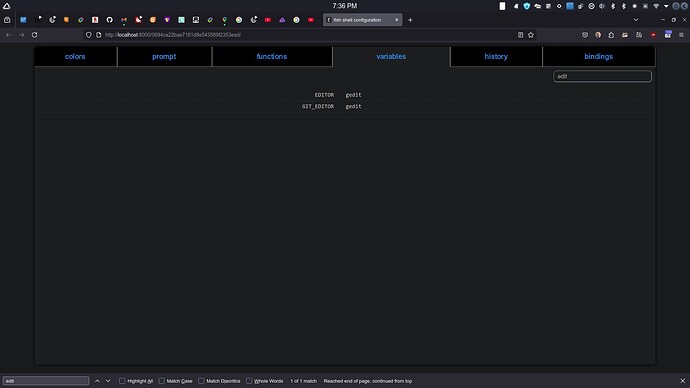

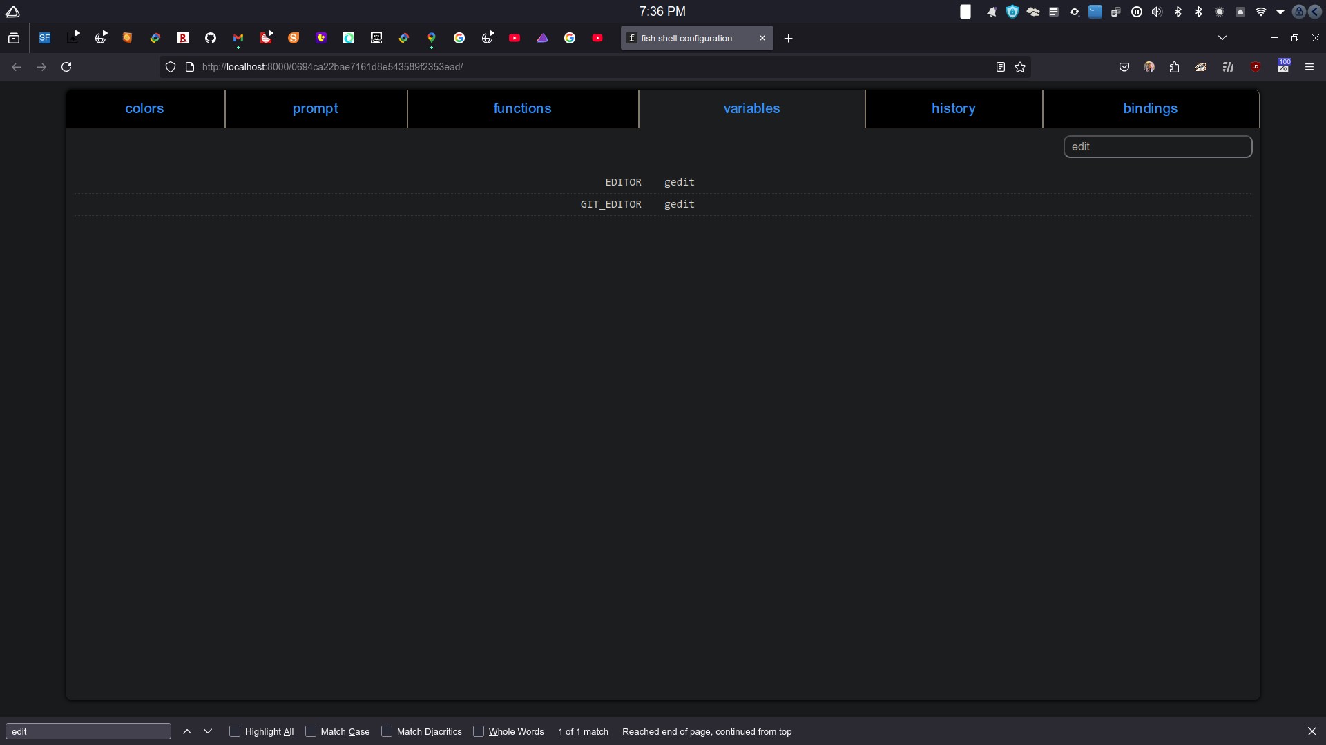

EDIT maybe it is set to gedit now that i look at this:
odd maybe it is solved and i didn’t know it… hmmmmmmmm
nope i typed in edit config.fish and it opened in vim :frowning:

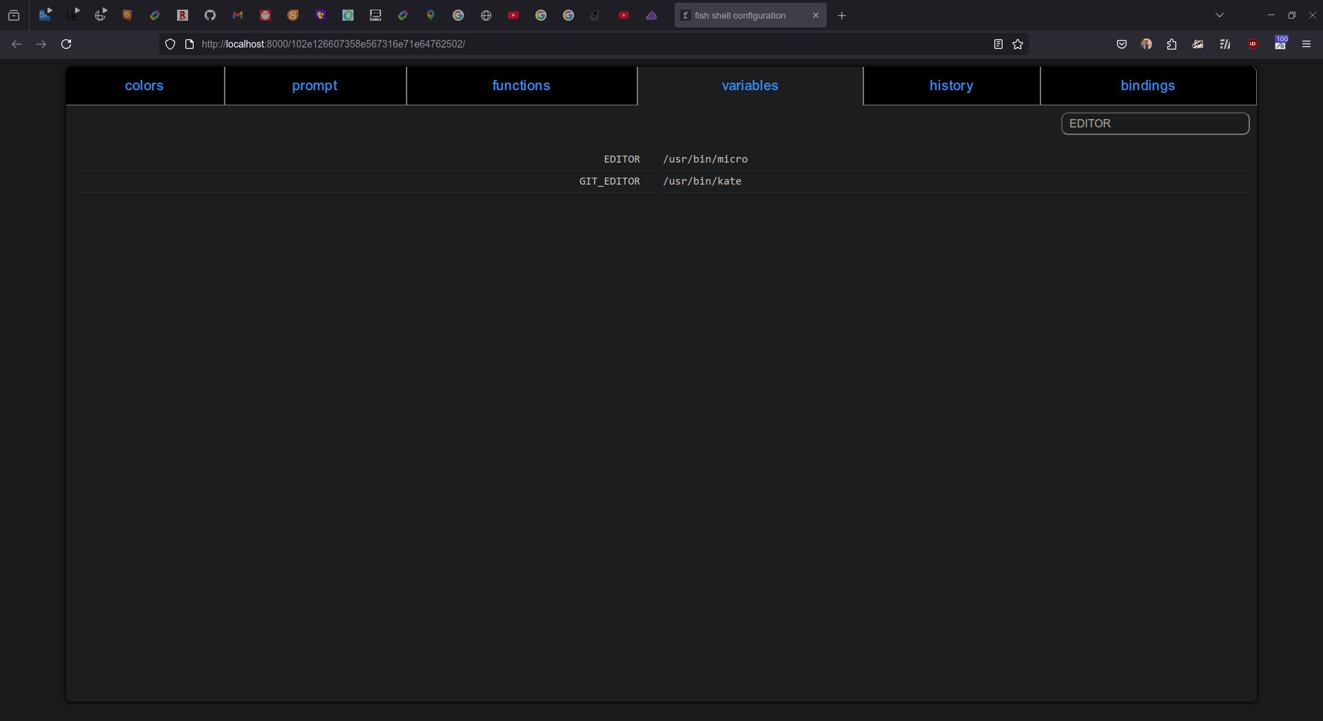

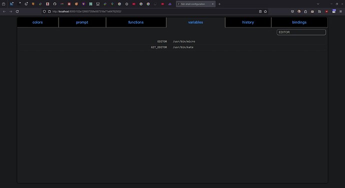

╭─    ~ ································································································································· 03:57:23 AM ─╮
╰─❯ # Editors                                                                                                                                                ─╯
    EDITOR=/usr/bin/micro
    SUDO_EDITOR=/usr/bin/micro
    VISUAL=/usr/bin/kate
    DIFFPROG=/usr/bin/meld
    GIT_EDITOR="/usr/bin/kate --startanon --block"
~/.config/fish/functions/fish_prompt.fish (line 2): Unsupported use of '='. In fish, please use 'set EDITOR /usr/bin/micro'.
in function '_tide_enter_transient'
╭─    ~ ································································································································· 03:57:25 AM ─╮
╰─❯ # Editors                                                                                                                                                ─╯
╰─❯ set EDITOR /usr/bin/micro
╰─❯ set GIT_EDITOR /usr/bin/kate
╰─❯ set VISUAL /usr/bin/kate
╭─    ~ ································································································································· 04:01:02 AM ─╮
DONE! (I think)
