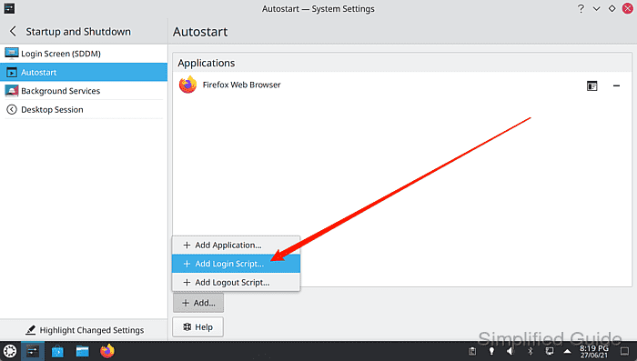

If you prefer to use a GUI, I think KDE has a way for you to add login scripts.
Just write a script containing the brightnessctl command and point the GUI to the script. The downside to this approach is that the script will only be run after you log in.

I didn’t know about that part of "autostart¨. Thank you!
Thank you!
