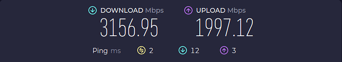

It’s not necessary to force the 2.5 GB option either. I don’t touch any settings in NetworkManager and I’m running 3 GB speed using a 10G Ethernet adapter and Cat 6A cable.
