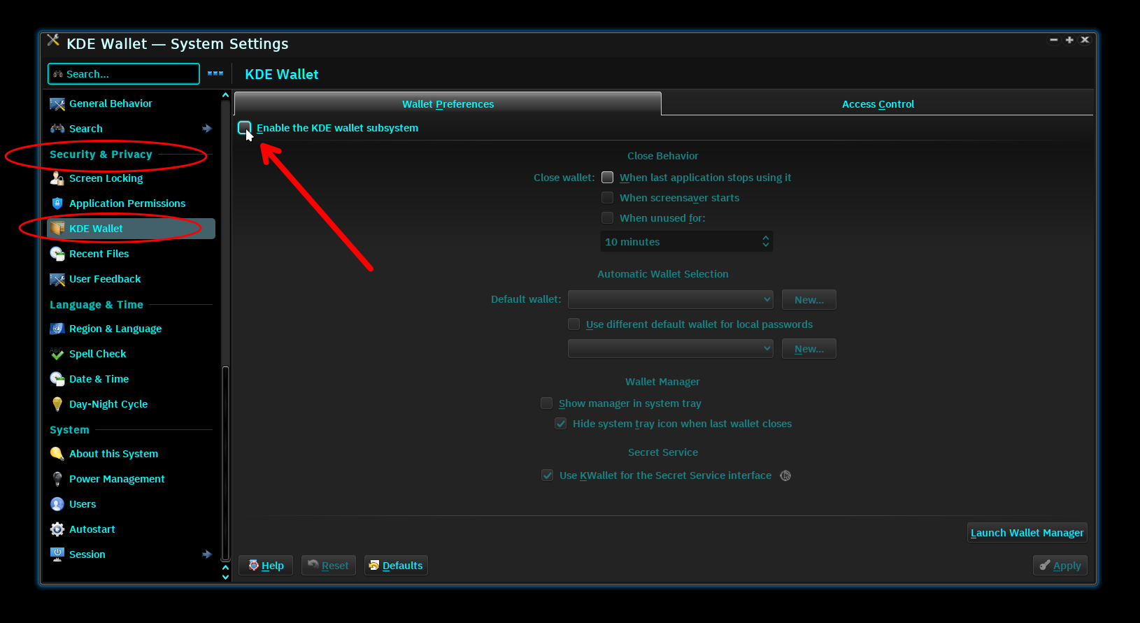

I seen it, it is for plasma 5, I don’t see KWallet options in the KDE settings
Also I don’t sure which wallet uses now, it can be keepsecret
I don’t have this page

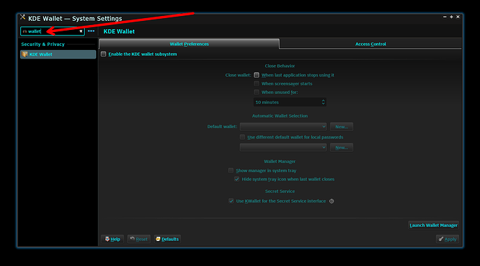

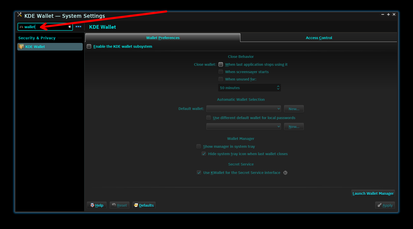

Type “wallet” in the Syetem Settings search bar:
Nothing
Then you’ve installed some other wallet (assuming you are using a wallet). Figure out what you installed.
