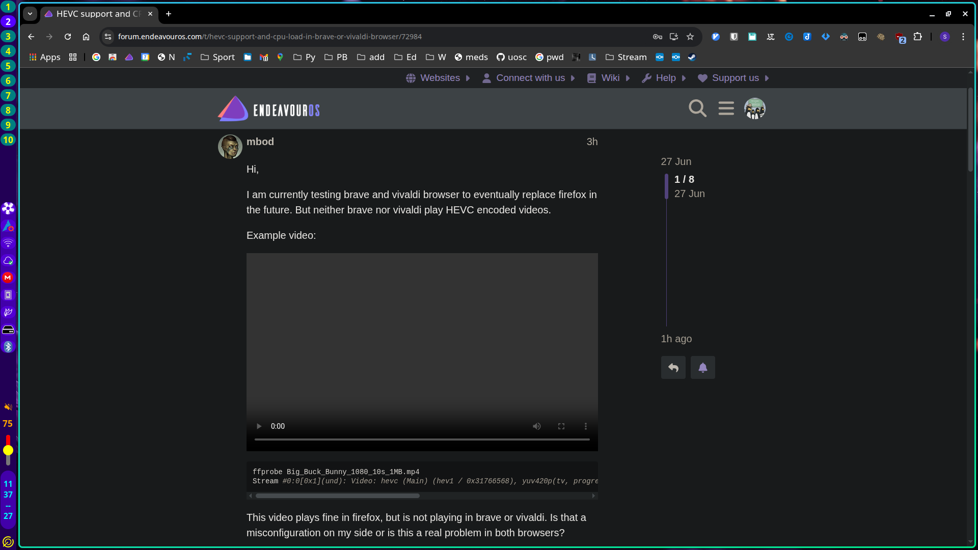

Hi,
I am currently testing brave and vivaldi browser to eventually replace firefox in the future. But neither brave nor vivaldi play HEVC encoded videos.
Example video:
ffprobe Big_Buck_Bunny_1080_10s_1MB.mp4
Stream #0:0[0x1](und): Video: hevc (Main) (hev1 / 0x31766568), yuv420p(tv, progressive), 1920x1080 [SAR 1:1 DAR 16:9], 834 kb/s, 30 fps, 30 tbr, 15360 tbn (default)
This video plays fine in firefox, but is not playing in brave or vivaldi. Is that a misconfiguration on my side or is this a real problem in both browsers?

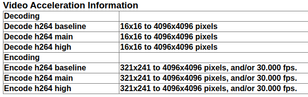

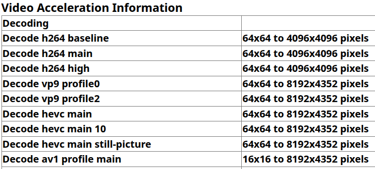

You can check the hardware acceleration status in vivaldi and brave by using the internal browser url: vivaldi://gpu or brave://gpu. This displays the GPU internals. At the bottom of the page you see “Video Acceleration Information”.
In my case this is:
Without the settings in ~/.config/brave-flags.conf this section is empty
For Chromium, this is under chrome://gpu.

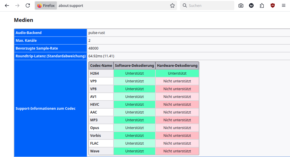

For Firefox, go to about:support and scroll far down, to the Media section:
(Yes, this is an old laptop from 2017, only H.264… And I didn’t know we could have audio hardware acceleration… Hm… :thinking:)
