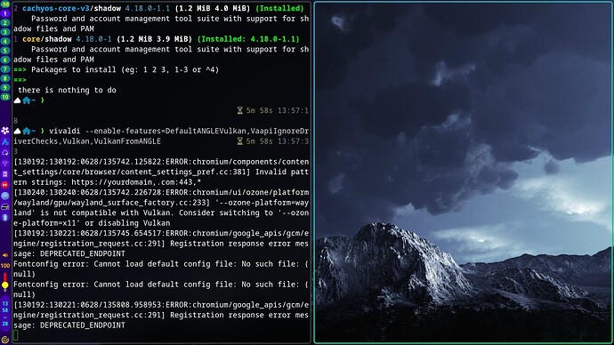

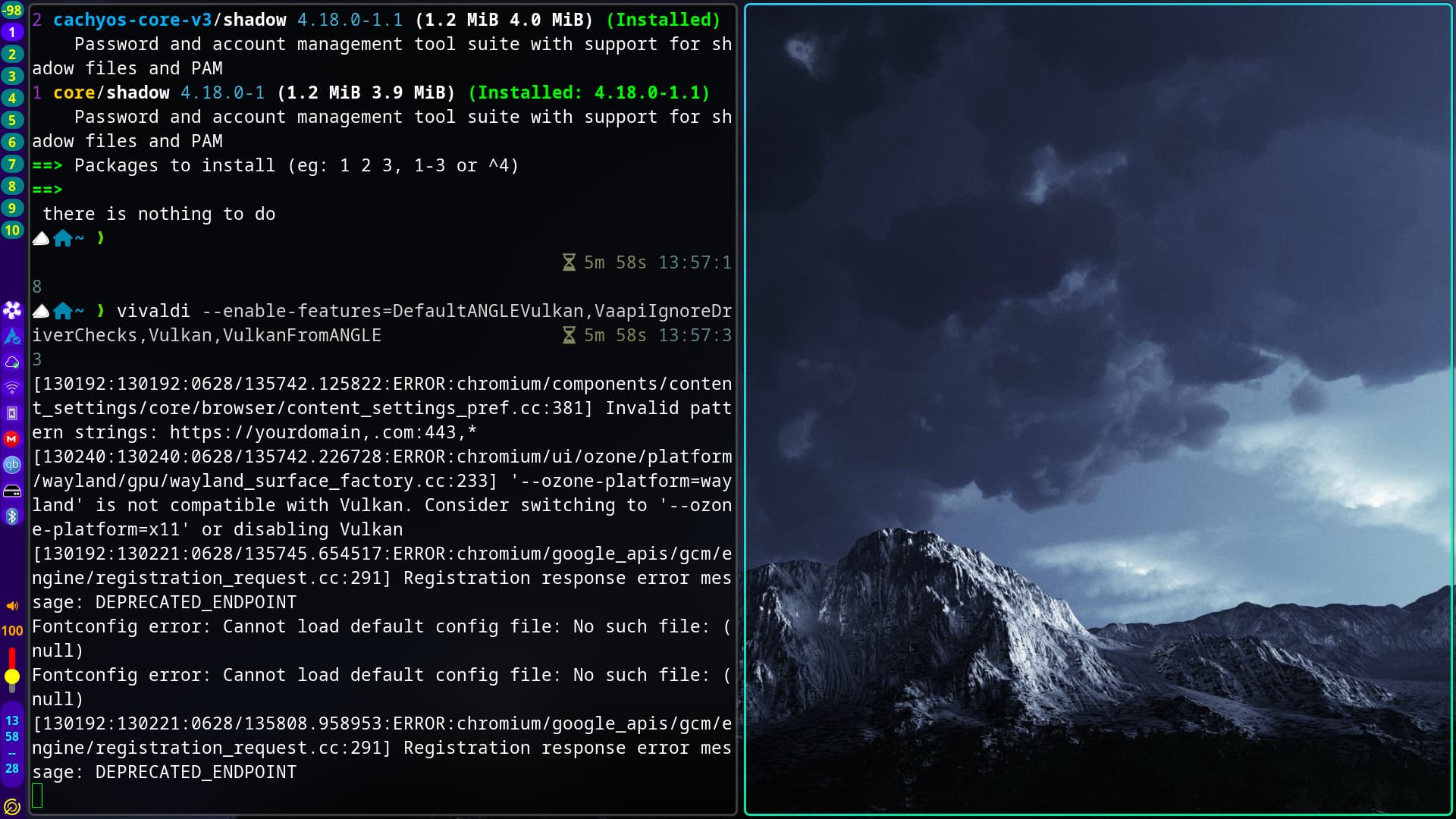

[michel@michel-crosshair15b12ugsz ~]$ vivaldi --enable-features=DefaultANGLEVulkan,VaapiIgnoreDriverChecks,Vulkan,VulkanFromANGLE
Wordt geopend in een bestaande browsersessie.
[2716:2716:0628/114606.070353:ERROR:chromium/components/sharing_message/sharing_service.cc:303] Device registration failed with fatal error
[2716:2813:0628/114634.917523:ERROR:chromium/content/browser/browser_main_loop.cc:278] GLib: g_main_context_pop_thread_default: assertion 'stack != NULL' failed
[2716:2812:0628/114634.917523:ERROR:chromium/content/browser/browser_main_loop.cc:278] GLib: g_main_context_pop_thread_default: assertion 'stack != NULL' failed
[2716:2814:0628/114634.917523:ERROR:chromium/content/browser/browser_main_loop.cc:278] GLib: g_main_context_pop_thread_default: assertion 'stack != NULL' failed

I started vivaldi with this commandline:
It also works when I put this commandline into the config file:
~/.config/vivaldi-stable.conf
(By the way, for brave the correct config file is ~/.config/brave-flags.conf)
For vivaldi the config file is
