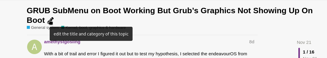

GRUB SubMenu on Boot Working But Grub’s Graphics Not Showing Up On Boot
I am not sure what is the exact nature of the issue you are facing.
You can get to Grub submenu. So I suppose you get to the Grub boot menu first.
So what does it mean that “Grub’s Graphics Not Showing Up”?
What are you expecting to happen/see when you boot your system which does not happen or you can’t see?
Please give some more detailed information.
The grub menu (console) from which you can choose which os you want to boot into and if you want to reboot into bios.
What I still fail to see is how you can get to the submenus without getting the menu first. :thinking:

Hi, is there some way to change the title of this forum post? If not should I create a new one. What I mean from the title is that GRUB’s menu (console version) is navigatable from the keyboard but it doesn’t appear on the screen.
