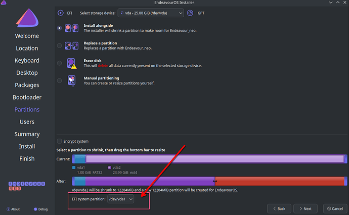

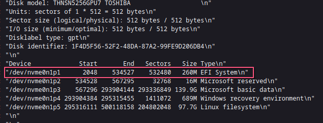

thats the issue… you may need to add a new EFI partition instead of using the one from windows:
here set efi to add new one:
I see you say on another drive so it is this one:

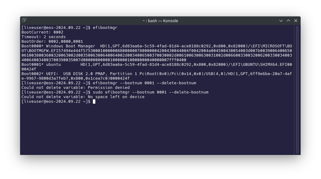

efibootmgr on livesession to see if you have unused entries in nvram… you can try removing them…

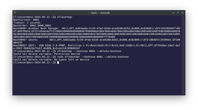

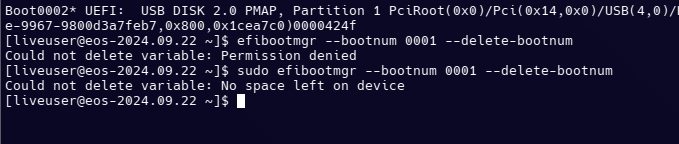

Okay so i checked efibootmgr first and it showed the windows bootloader but also an ubuntu boot partition from an earlier attempt with linux mint to see if it gave the same error, which it did, so i deleted it, but after a restart i saw it was still there somehow. Eventually decided to clean up my drive where the windows install is but that didn’t help either so i did a clean reinstall of windows 10 just on the drive it was already on which also did nothing. Then went into the bios to see if i can delete that ubuntu boot but the same thing happened it just keeps coming back. I tried to delete it through efibootmgr in a live session but that comes back with the following:

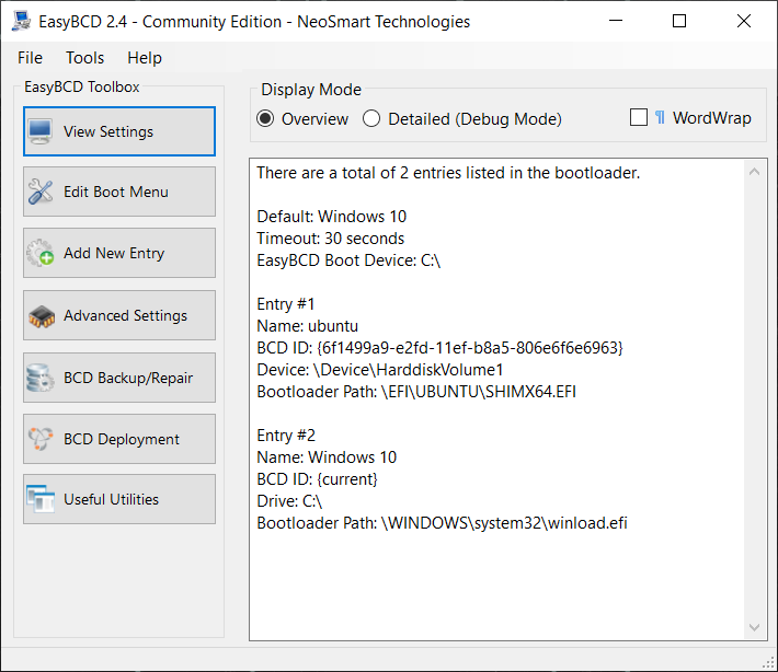

tried for a while to fix it within windows using easybcd and bcdedit but to no avail. I did however find that the bios registers it as stored on the drive windows is on but bcdedit and easybcd only see it as being on a partition named \devices\harddiskvolume1
which is seemingly a ghost partition since i can’t find that path anywhere else. i have confirmed that there is more than enough space on the windows drive (about 177GB) and the drive i’m trying to install endeavouros on is completely unallocated space. I will say i’m not entirely sure how to clean out nvram since i could only find how to do that on a router for some reason but as of right now the error is still exactly the same.

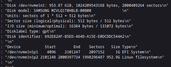

/dev/nvme1n1p1 4096 2101247 2097152 1G EFI System
this is the partition it tries to add bootloader on … it could be it failes to mount it properly it could be corrupted or something too so no space left could be false error … you may have fast boot not disabled on windows?
And in case the full drive is free for Linux you can try completely erase it … something like secure erase or using partition manager to do that.
