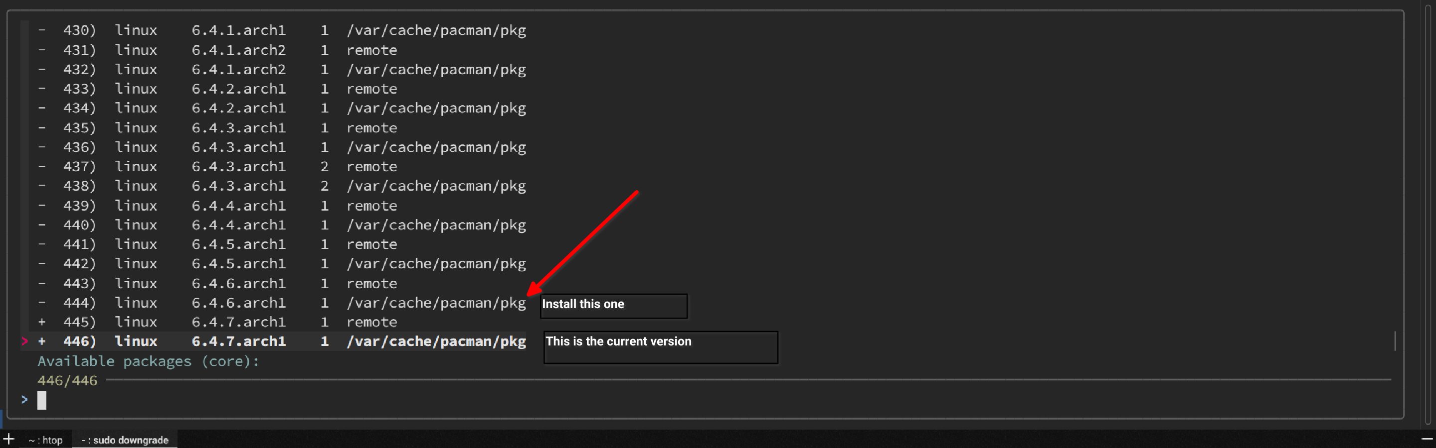

Ok, understood. For now I was suggesting that you downgrade the kernel. You can do so by using the command sudo downgrade linux. If you also have the linux headers installed or any other kernels and their headers then you would just add them to that command. For example, my systems has three kernels. The default arch kernel, the zen kernel, and the lts kernel. In my case the command would look like this linux linux-zen linux-headers linux-zen-headers linux-lts linux-lts-headers.
When you run the command you should select the previous version that was working for you.
It should look something like this when you run the command.
Once you have selected the previous working kernel and it installs. You should reboot and see if that gets you back into a working state.
