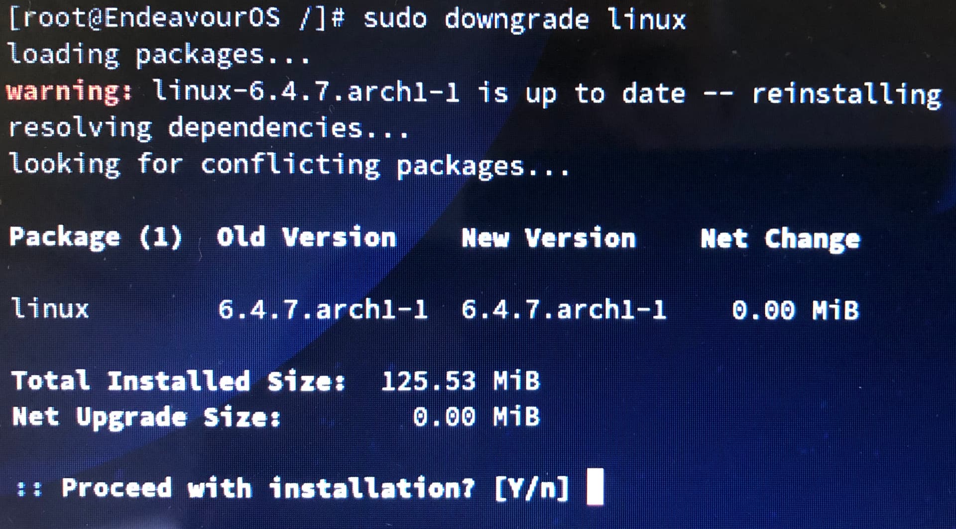

Unfortunately, I am not presented an older kernel. Here’s the result of sudo downgrade linux:

That is strange downgrade is supposed to check pacman cache and the arch linux archive. You can manually download the packages from the arch linux archive and then use pacman to install them. https://archive.archlinux.org/packages/l/linux/ and https://archive.archlinux.org/packages/l/linux-headers/ if you also have the kernel headers installed.

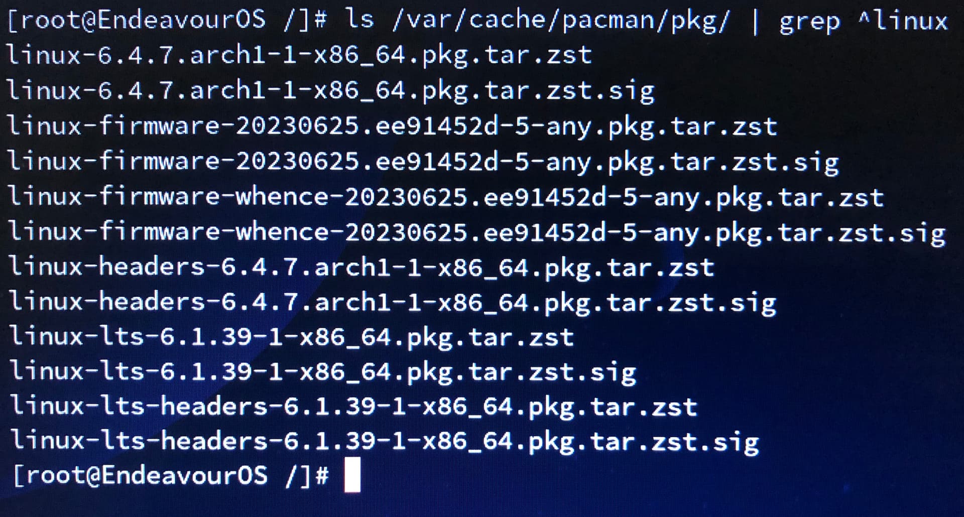

Another thing I just thought of in order to downgrade the kernel is to use the command ls /var/cache/pacman/pkg/ | grep ^linux and report the output here, so I can see if you still have the previous kernel already in your cache. I probably should have thought of this earlier, my bad. :sweat_smile:
Obviously, the older kernel got removed by eos-update:
