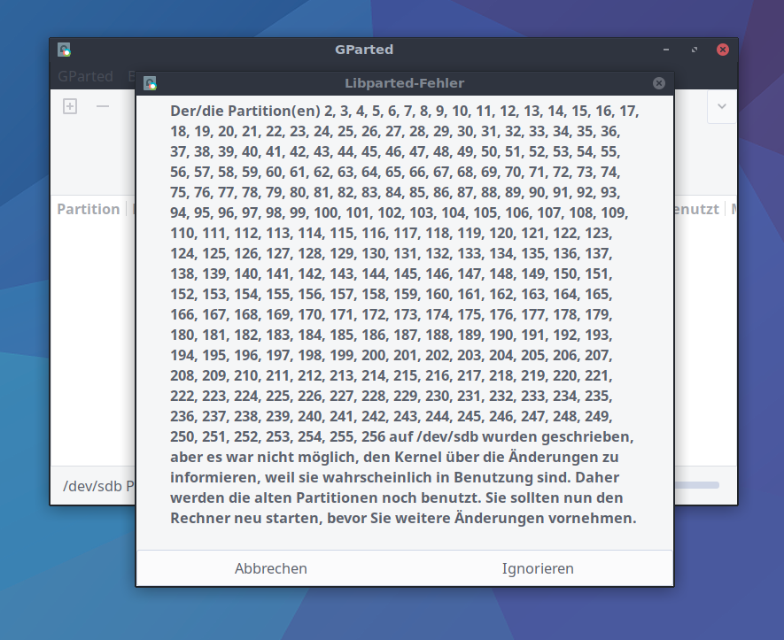

I reinstalled EOS XFce on a computer with SSD, mounted the partitions in the etc/fstab, rebooted the computer. To see if everything fits, I started Gparted and got the following message window:
Bildschirmfoto_2020-09-11_00-42-23
I have 3 partitions on sda: EFI Boot, root and swap
What is broken here?

I Just launched Gparted and received five of those screens. My hunch it’s something to do with today’s kernel update. I saw it once a good will back under Manjaro and then it just went away. Hopefully someone here has a solution, cause I know there is nothing wrong with my drives or partitions.
Kernel 5.8.8-zen1-1-zen

I just opened Gparted and got 2 of those screens as well. Gparted should be very happy with my set up, it was installed yesterday, using Gparted as the tool to make the partitions. I would agree that it’s because of something that has changed. I’m using 5.8.8-arch1-1 kernel, are you using the same @anon14644943 ?
Going to boot live and I bet I don’t get this. Be back.

Booted the Live EOS and ran Gparted without any issue.
@ramblinwreck 5.8.8-arch1-1 :thinking:
Boot into the LTS or some other kernel and see if it does it for you there.

You are right, everything is fine with kernel 5.7.8 from Live.ISO. So a problem with the kernel. Can you ignore it?

Yes… it looks like an issue with the file. I’m getting it also now since updating the kernel.
Screenshot_20200910_220219
Can you do anything with it? Or better said, is it negligible if everything else is going well? All partitions are booted correctly.
