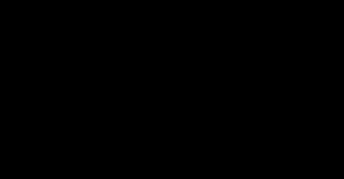

Edit: Below, you can see how my background turns black. However, when I press the Windows key, the background shows up correctly. I can still open apps and everything functions normally, but it’s a bit odd.
