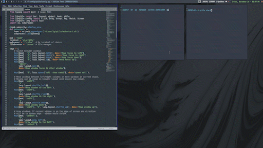

I haven’t gotten the Zephyr script working yet, but reading the documentation also clued me into the fact than I can switch to tty2 and start a separate X session to test Qtile.
Got Xephyr working! Now testing Qtile is a breeze. Thanks to you and @flyingcakes who let me know about the example command on Arch Wiki that got it working for me.

Luckily the folks here and in the unofficial Discord server have taught me about Xephyr! It makes testing Qtile without restarting it a breeze. Creates a nested X session to check everything out in before restarting Qtile in your main session. Demonstration:
xephyr-in-action_SparkVideo
https://docs.qtile.org/en/latest/manual/config/index.html#testing-your-configuration
https://wiki.archlinux.org/title/Xephyr#Execution
