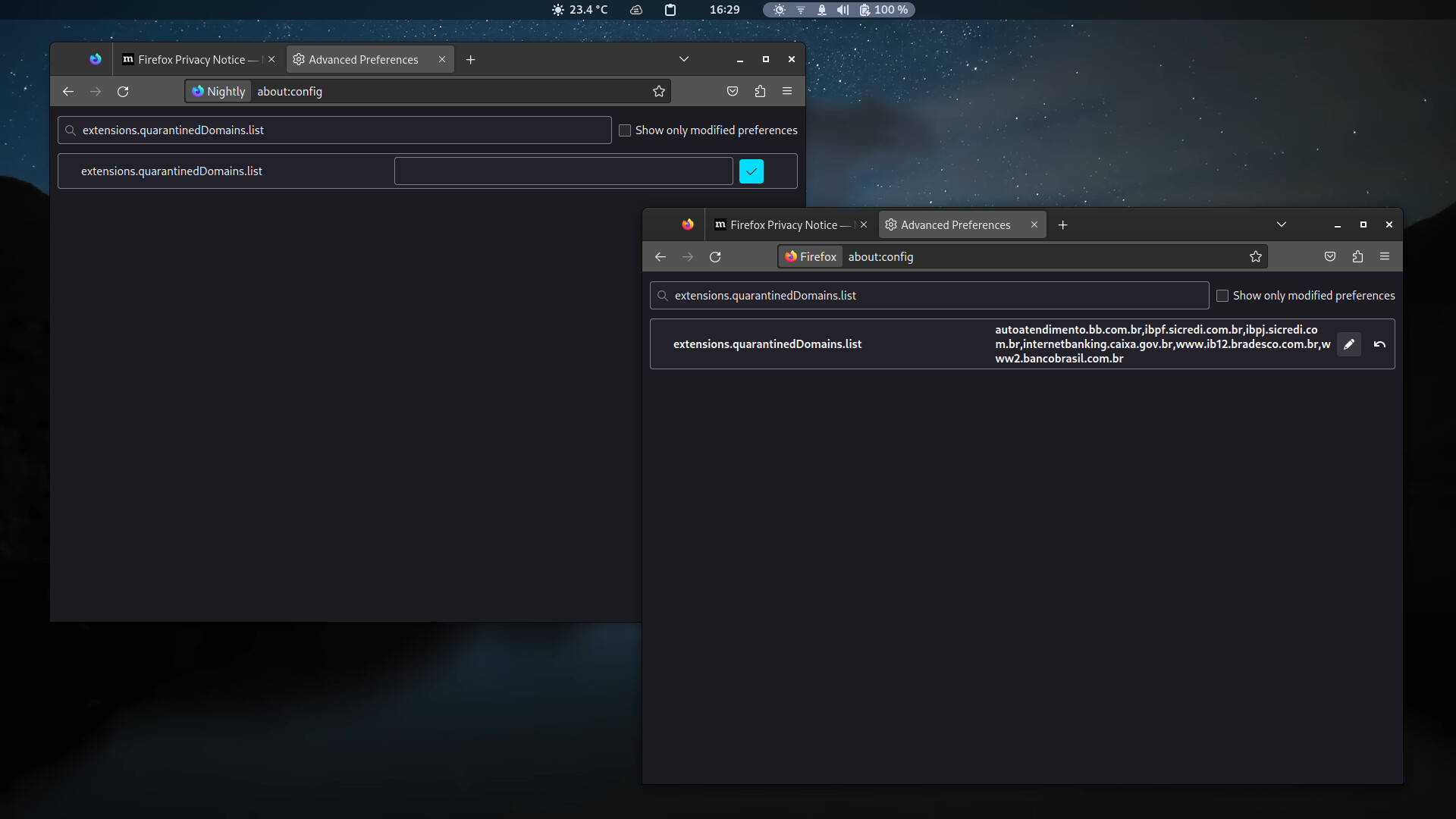

Screenshot from 2023-07-08 16-06-24
I am denying connection (or what I think I am doing) to all these.
Yet, the field gets populated again :no_mouth:
The Fox means business ! :sweat_smile:
Edit: If this tell you something?

“Fresh” profiles for Nightly and Regular
  1. Disconnected for the Internet >> extensions.quarantinedDomains.list empty in both.
  1. Connected to the Internet: extensions.quarantinedDomains.list populated for FF 115 (even without restart :open_mouth:) but not for FF 117 (Nightly)
This is intriguing :rofl:

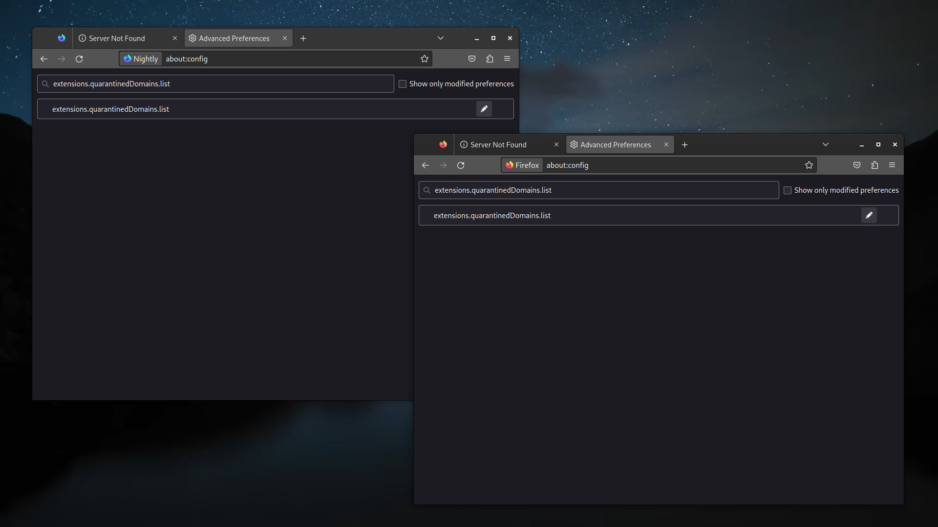

A bit of an update:
I made those deny rules for Nightly’s firefox-bin to not connect to those destination posted before.
Not for FF 115.
Now after launching both, without internet connection, the list was empty for both.
As soon as the connection was established, the list got populated for FF 115 (without restart) and not for FF 117.
In 117, I went to: Help >> About Nightly >> Checking for updates >> Failed
The list being still unpopulated, I am seeing:
We got the “culprit” ?
:thinking:
hmmm, it is using a Mozilla DNS server just for that ?
That is why my /etc/hosts entries didn’t work.
That sounds to me an attempt to force the use of that list. Definitely not looking good for the Fox…
It could be one of these two.
I’m going to remove one and test.
I guess we might have it!
Removed: content-signature-2.cdn.mozilla.net
Restarted the Fox!
Checking for updates >> failed!
extensions.quarantinedDomains.list >> populated !!
