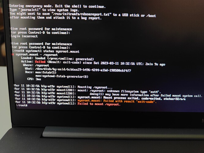

Recently have been experiencing this error after each restart. It takes 3-4 reboots just to get to the system. Logs (fstab and inxi): https://0x0.st/HiLv.txt
The error itself:
you have what appears to be a corrupt system. It tells you that ext4 is unknown file type. you could have a corrupt file system or you can have a harddrive that is failing. When did this first happen? Was it after an update did you install a program then this happended. We can sit and guess all day. You should post the log files. explain to us what you were doing when this first started. since ext4 is showing as unknown I would say that you lost / corrupted your filesystem

Do you have multiple Linux installs? Did you modify the bootloader at any point? unknown filesystem type: ext4 is caused by attempting to mount the wrong partition in my opinion, not a hardware failure.

мар 11 13:35:54 hly-w19r kernel: EXT4-fs (nvme0n1p7): mounted filesystem 6cb-XXX with ordered data mode. Quota mode: none.
in this case it loads ext4 just fine … boot journal do not show any issue related…
yes i do not think this is hardware failing…
But could be the ESP is corruüted or kernel images having a brick falling off…

Yes, it was showing that there is dirty bit and the fs haven’t been unmounted properly
Dirty bit is set. Fs was not properly unmounted and some data may be corrupt.

When I ran the kernel rebuild some commands haven’t been found, so after the reboot error reappeared.
