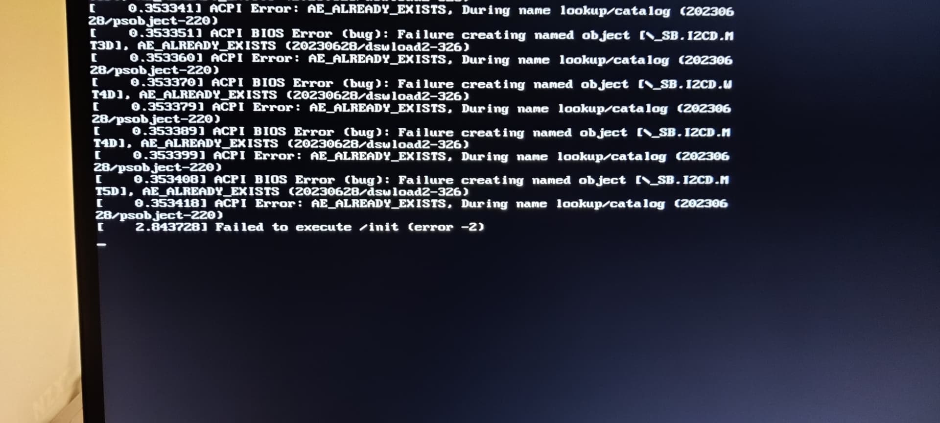

Hello,
after updating the system I get this error at boot time
Failed to execute /init (error -2)
From chroot I reinstalled systemd-boot and also the kernel but nothing changed.
Can anyone help me? What information is needed?
Can we see what occurs before that error?

Try installing linux-lts. pacman -S linux-lts linux-lts-headers and see if you can boot off the LTS kernel.
With linux-lts I get a black screen at startup
What happens if you temporarily remove this part:
I tried but nothing changes.
I tried to install reFIND and configure it manually but in the boot menu there are no system entries. It doesn’t seem to see the partition.
fdisk of the boot partition reports this:
Disk /dev/nvme1n1p1: 1000 MiB, 1048576000 bytes, 2048000 sectors
Units: sectors of 1 * 512 = 512 bytes
Sector size (logical/physical): 512 bytes / 512 bytes
I/O size (minimum/optimal): 512 bytes / 512 bytes
Disklabel type: dos
Disk identifier: 0x00000000
Why is the partition table MBR? should it be GPT?
kernel downgrade reports this:
typedracut: *** Creating initramfs image file '/boot/initramfs-6.5.9-arch2-1.img' done ***
Running in a chroot, skipping cmdline generation
(4/5) Check if user should be informed about rebooting after certain system package upgrades.
System has not been booted with systemd as init system (PID 1). Can't operate.
Failed to connect to bus: Host is down
(5/5) Checking which packages need to be rebuilt
fatal library error, lookup self
or paste code here
Can you share the full output of sudo parted -l
Those last two hooks may not work in a chroot. Neither of them are critical though. They are both informational.
[liveuser@eos-2023.08.05 ~]$ sudo parted -l
Model: ATA ST8000DM004-2CX1 (scsi)
Disk /dev/sda: 8002GB
Sector size (logical/physical): 512B/4096B
Partition Table: gpt
Disk Flags:
Number Start End Size File system Name Flags
1 17.4kB 16.8MB 16.8MB Microsoft reserved partition msftres
2 16.8MB 8002GB 8002GB Basic data partition msftdata
Model: Kingston DataTraveler 3.0 (scsi)
Disk /dev/sdb: 62.0GB
Sector size (logical/physical): 512B/512B
Partition Table: msdos
Disk Flags:
Number Start End Size Type File system Flags
1 1049kB 62.0GB 62.0GB primary fat32 boot, lba
Model: Samsung SSD 980 PRO 1TB (nvme)
Disk /dev/nvme0n1: 1000GB
Disk Flags:
1 1049kB 106MB 105MB fat32 EFI system partition boot, esp, no_automount
2 106MB 123MB 16.8MB Microsoft reserved partition msftres, no_automount
3 123MB 999GB 999GB ntfs Basic data partition msftdata, no_automount
4 999GB 1000GB 780MB ntfs hidden, diag, no_automount
Model: WD Blue SN570 1TB (nvme)
Disk /dev/nvme1n1: 1000GB
Disk Flags:
1 2097kB 1051MB 1049MB fat32 boot, esp
2 1051MB 1000GB 999GB ext4 endeavouros
It looks like all your disks are all GPT except for the one you used to boot the ISO.
why is the disk label of the boot partition “dos”? it should be “gpt”
sudo fdisk -l /dev/nvme1n1p1
Disklabel type: dos
Perhaps because you ran fdisk on the partition instead of the disk?
What happens if you do sudo fdisk -l /dev/nvme1n1 ?
yes, gpt
Disk /dev/nvme1n1: 931.51 GiB, 1000204886016 bytes, 1953525168 sectors
Disk model: WD Blue SN570 1TB
Disklabel type: gpt
Disk identifier: 158359A8-2428-489F-B214-CAB4B4614908
Device Start End Sectors Size Type
/dev/nvme1n1p1 4096 2052095 2048000 1000M EFI System
/dev/nvme1n1p2 2052096 1953520064 1951467969 930.5G Linux filesystem
bootctl --boot-path=/boot install
/dev/nvme1n1p1: Partition has wrong PART_ENTRY_TYPE=c12a7328-f81f-11d2-ba4b-00a0c93ec93b for XBOOTLDR partition.
That isn’t how we boot. Just do bootctl install if you want to reinstall it.
Be sure that your EFI partition is mounted to /efi
