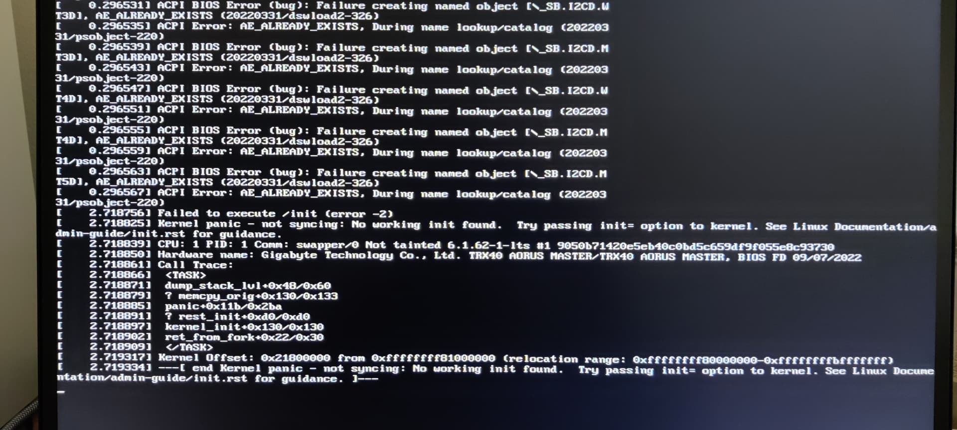

Failed to execute /init (error -2) After update

entries are created, but at boot always the same error "Failed to execute /init (error -2)
