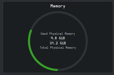

Despite closing every desktop app and my system monitor listing less then 1G of RAM being used by apps, I have just under 9G being used, this gets worse over time. (about 1G is being used by vivaldi to make this post)

I was trying to say: what you are seeing is totally normal. If your system has tons of free memory and doesn’t actually need that RAM freed up for another process, it will just leave it cached there. If you wind up needing to use pages that were cached there later, great–they are ready to go. If not, no harm done.
Look, you have almost 10 GB in your RAM cache:
That exactly correlates with what you are describing. You open a bunch of applications, they actively use a bunch of RAM, you close them, the information those applications stored in memory stays in the buffer in case you need it again, until something else asks for the RAM.

Garbage collection in Linux is a bit lazy. I noticed too my RAM stays marked as used when i close memory intensive applications. Linux has this philosophy of making the most use of your whole RAM instead of trying to keep the usage to a minimum. Empty RAM doesn’t do anything good for the system. It just sits there unused.
My main issue with this is there being no way to free up this RAM. It becomes a problem when I try to run a memory intensive game or application and my system locks up because of it. It seems an occasional reboot seems like the best way to clear it.
It is free. If an application needs memory, the kernel just overwrites the buffer. If nothing needs the RAM it just leaves the buffer alone, because why not?
Did you read the article yet? It mentions a way to manually purge the buffer if you insist on doing that.
How do I stop Linux from doing this?
You can’t completely disable disk caching, (but you can tune Linux’s “swapiness”). The only reason anyone ever wants to disable disk caching is because they think it takes memory away from their applications, which it doesn’t! Disk cache makes applications load faster and run smoother, but it NEVER EVER takes memory away from them! Therefore, there’s absolutely no reason to disable it!
If, however, you find yourself needing to clear some RAM quickly for some reason, like benchmarking the cold-start of an uncached application, you can force linux to nondestructively drop caches using echo 3 | sudo tee /proc/sys/vm/drop_caches.

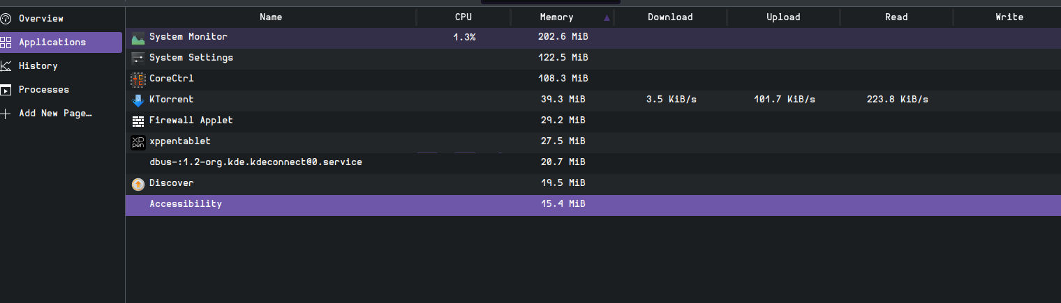

PS: Also memory evaluation is hard, and plasma’s “new” System Monitor is not the best tool for the job. But if you use it go over to the Processes tab and also activate Show: All Processes in the drop down at the top.
The 9Gb was after a hour of playing a game with proton, I don’t have the normal kernel currently installed. The processes tab looks similar, with the memory % not adding up to actual RAM usage.
Estimating memory is hard because of e.g. shared libraries, so don’t expect that to add up to the used value. But the Processes view with All Processes shows you a lot more than just the Applications view.
Maybe some proton process isn’t shutting down properly, wouldn’t be that uncommon. You have to take a look when you notice the situation.
