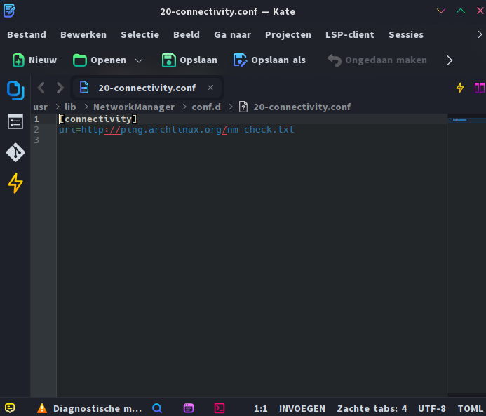

Here’s the solution for pinging archlinux.org almost 5 years ago.
And here is how it looks now (no changes made to be clear).
For years it was a reliable indicator that the internet connection was actually down.
For the last month (?) I see it maybe once or even twice a day with the network still connected. No idea what’s going.
Delete this line in /usr/lib/NetworkManager/conf.d/20-connectivity.conf
then go to
/etc/NetworkManager/conf.d/20-connectivity.conf
and add
[connectivity]
.set.enabled=false
