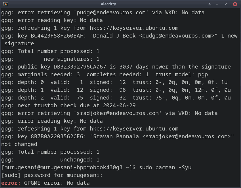

Error: GPGME error: No data - new
error: GPGME error: No data error: failed to synchronize all databases (unexpected error)
I am getting the above errors and tried the following.
Nothing works
  • eos -rankmirrors
  • sudo pacman -Syyu
  • sudo rm -r /var/lib/pacman/sync/
  • sudo pacman -Syu
  • sudo cp -f “/etc/pacman.conf” “/etc/pacman.conf.orig”
  • sudo sed -i ‘s/SigLevel.*/SigLevel = Never/’ /etc/pacman.conf
  • sudo pacman -Syy gnupg archlinux-keyring endeavouros-keyring
  • sudo mv -f “/etc/pacman.conf.orig” “/etc/pacman.conf”
  • sudo pacman -Syu
still getting
Please help.

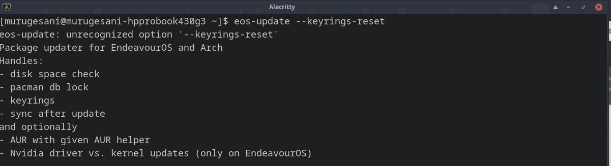

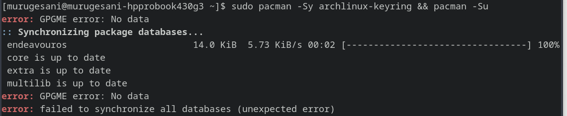

You could try this command:
eos-update --keyrings-reset
Edit: note that I wouldn’t recommend playing with SigLevel values.
Thanks.
I am getting eos-update: unrecognized option '--keyrings-reset'.
OK, you probably have an older version of package eos-bash-shared.

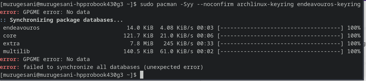

Instead you can run commands
sudo mv /etc/pacman.d/gnupg /root/pacman-key.bak
sudo pacman-key --init
sudo pacman-key --populate archlinux endeavouros
sudo pacman -Syy --noconfirm archlinux-keyring endeavouros-keyring
sudo pacman -Syu
error: GPME error: No data
while running the below command.
Have you tried sudo pacman-key --refresh-keys
I tried sudo pacman-key --refresh-keys now.
It didn’t solved.

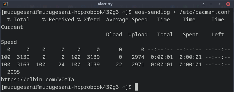

Can you please show the output of command
eos-sendlog < /etc/pacman.conf
Hi,
Are you using ARM?
Are you asking about system processor?
Not ARM.
It is Intel-I7.

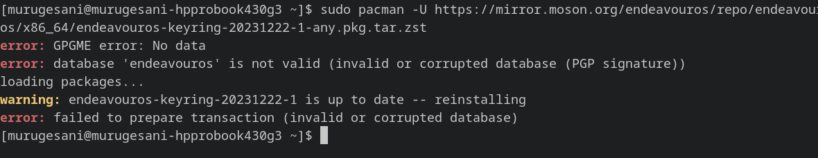

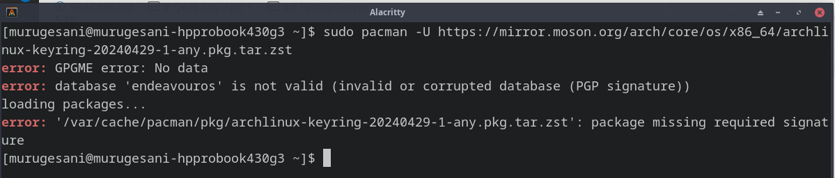

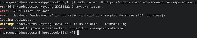

You could try installing the keyring packages manually.
sudo pacman -U https://mirror.moson.org/arch/core/os/x86_64/archlinux-keyring-20240429-1-any.pkg.tar.zst
sudo pacman -U https://mirror.moson.org/endeavouros/repo/endeavouros/x86_64/endeavouros-keyring-20231222-1-any.pkg.tar.zst
and then try updating again.
Thanks.

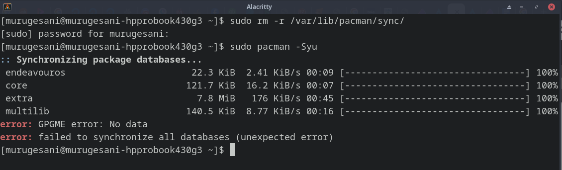

Did you already try deleting all files from /var/lib/pacman/sync/ ?
Edit: if this does not help, you can try commenting out the [endeavouros] repo lines from /etc/pacman.conf.
Also, better backup your personal data to an external drive, just in case.
Yes with sudo rm -r /var/lib/pacman/sync/
