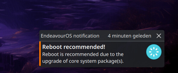

Guys, made some minor changes to eos-reboot-recommended, new version is 26.2-1.
Please test it and report.
Note that you probably want to check if the changes in file /etc/eos-reboot-recommended.conf.pacnew need merging to your /etc/eos-reboot-recommended.conf.
For example:
sudo meld /etc/eos-reboot-recommended.conf.pacnew /etc/eos-reboot-recommended.conf
Default conf doesn’t notify, still requires user and/or expire time.
I set it on 30 (seconds) and :ok_hand:t2:
Here it works with all old and new settings.

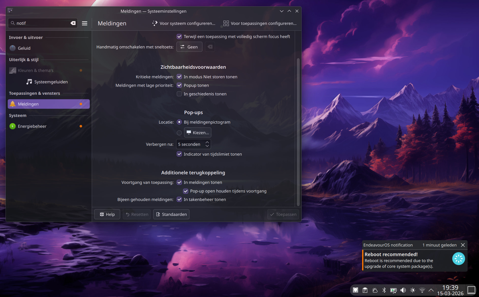

So some questions:
  1. Is your system fully updated?
  2. Can you show the full contents of your /etc/eos-reboot-recommended.conf that doesn’t notify?
  3. Did you try command: sudo pacman -S mesa
Yes, fully updated. Yes, testing with mesa.
