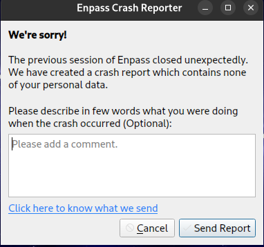

I’m using Enpass on my systems for a long time. But It is not possible to start Enpass anymore.
I removed and reinstalled Enpass, without no success.
Starting Enpass from GNOME-Shell (GUI) shows following message:
grafik
