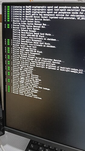

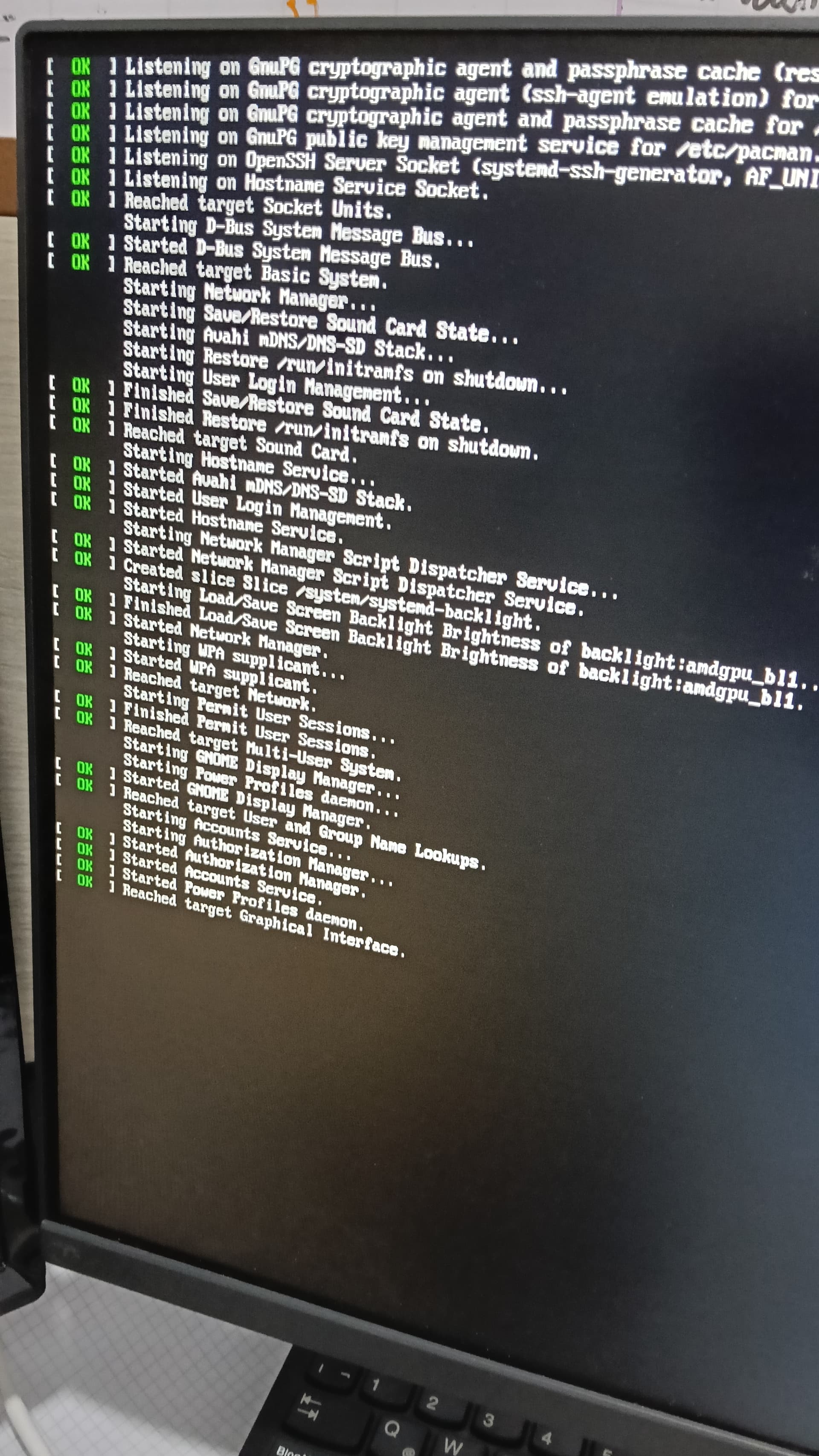

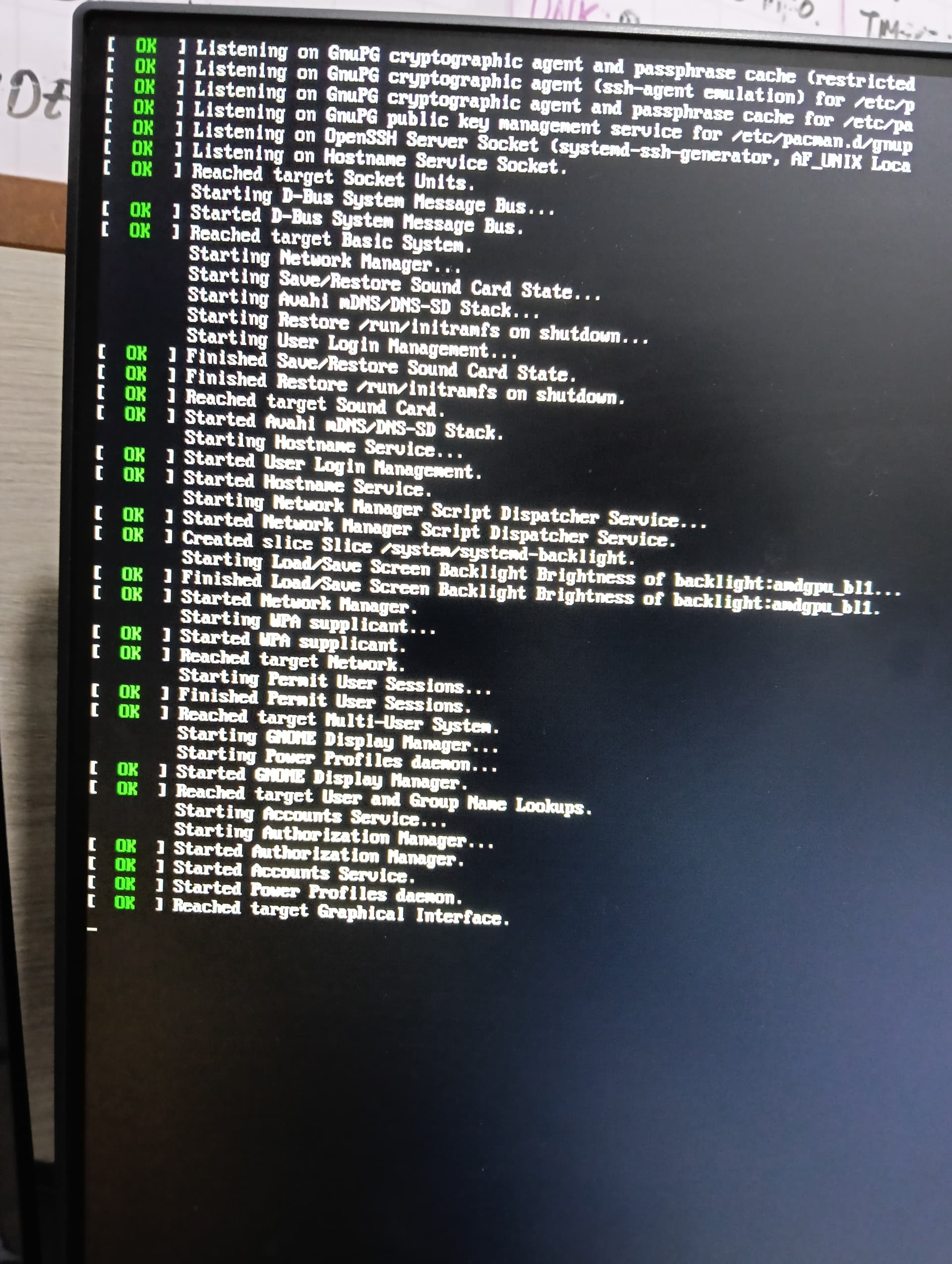

This is what I am getting after removing the quiet on the kernel
It stuck in there flashing the screen
I was referring to this. Your images are fine but i have no idea what’s stopping it or making it hang. :thinking:
