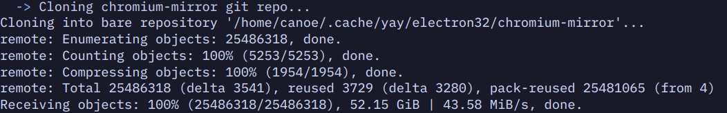

Electron (27 I think) dependency for Arduino IDE 2 triggered a mega system upgrade
I think it downloaded more than 40GB and lasted more than 8 hours. I left it to download overnight (was curious) and let it install while doing something else.
… but this is not normal. how gets so much bloat built and accepted.
I have uninstalled arduino-ide and installed the bin version, and hopefully got rid of the electron dependency…
See here…
Electron27 is still in the Arch repos, as it should be, since arduino-ide is also in the arch repo. This must be something different.
I didn’t see any dependencies on electron with the AUR-sourced bin version; it’s also newer than the Arch repo version. This Gitlab thread explains what’s going on with the new package version: https://gitlab.archlinux.org/archlinux/packaging/packages/arduino-ide/-/issues/2
That is the consideration for the next update, but currently the somewhat older version requiring electron27 are both still in the Arch repo. You shouldn’t have get an arduino-ide update for that reason. Nothing from the Arch repos should ever compile.
Agreed. The fault, however, is Arduino IDE being stuck on an Electron version that’s been EOL for quite a while now. It’s the only reason that electron27 is still in the AUR.
Yes, but electron27 is not in the AUR, it’s in the Arch repos, it does not cause the download of 40 GB and hours of compilation. There was something else going on in whatever was updated, and it’s probably not solved by switching to arduino-ide-bin.
OK, I just noticed that - sorry. What does paclog --after=2025-05-09 show?
