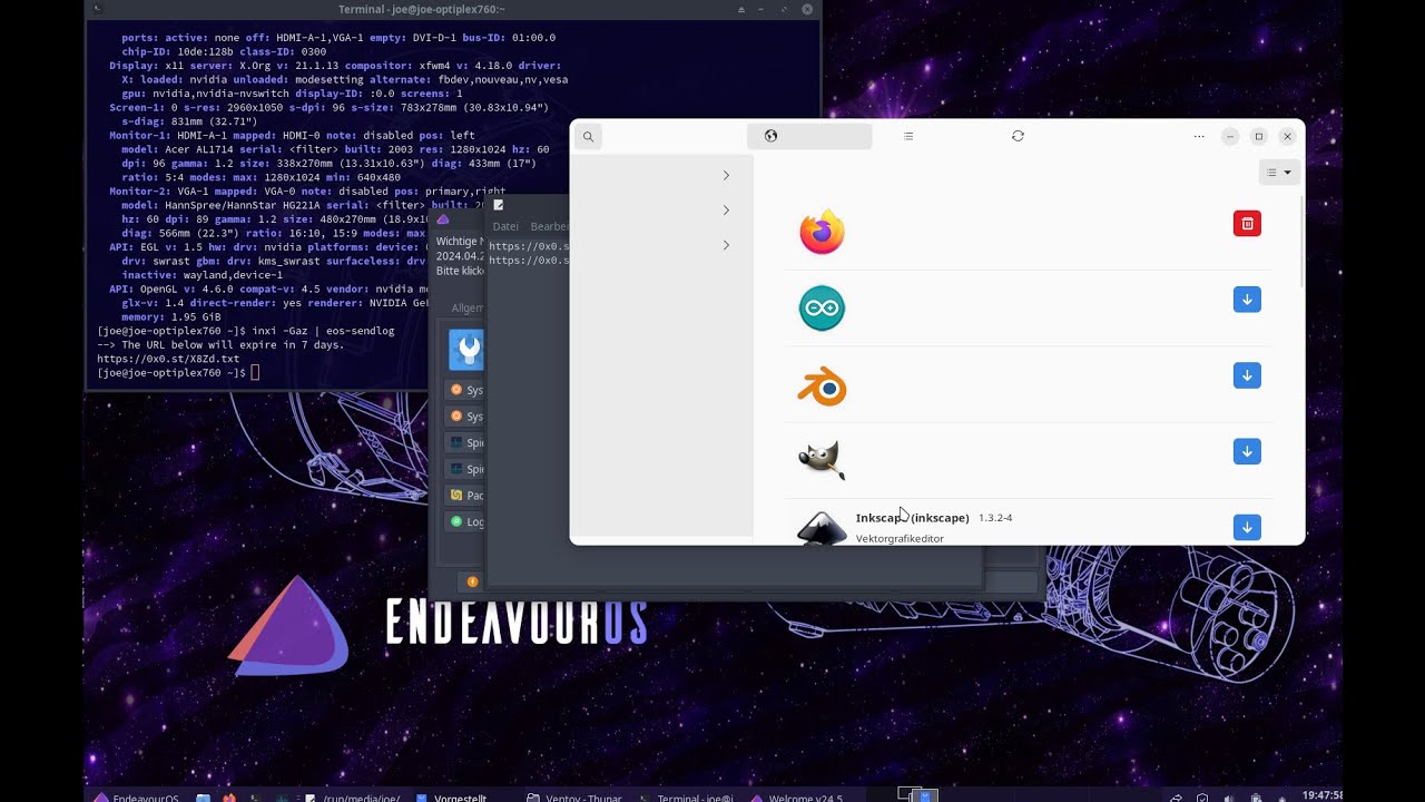

is what i use now… i have some legacy devices laying around indeed… a gforce 610 and geforce 710… the 710 should be 128b
Should i insert? … ah just realize it is used inside my daughter’s PC … only the 610 (old legacy) and oldr ATI HD card left. I could try using an extra drive on the machine where it is plugged in and install EndeavourOS with 470xx drivers…
As my daughter is out helping a friend with math, i was able to take over the PC of her… and done installing EOS now building 470xx drivers… takes a bit…
https://0x0.st/X8Zd.txt
https://0x0.st/X8Z5.txt
So i can vallidate this glitch with 470xx nvidia drivers and libadwaita apps…

make[3]: *** [scripts/Makefile.build:243: /var/lib/dkms/nvidia/470.239.06/build/nvidia/nv-i2c.o] Error 1
make[3]: *** [scripts/Makefile.build:243: /var/lib/dkms/nvidia/470.239.06/build/nvidia/nv-procfs.o] Error 1
/var/lib/dkms/nvidia/470.239.06/build/nvidia/nv-acpi.c: In function ‘nv_acpi_methods_init’:
/var/lib/dkms/nvidia/470.239.06/build/nvidia/nv-acpi.c:644:22: error: implicit declaration of function ‘acpi_bus_get_device’; did you mean ‘acpi_is_pnp_device’? [-Wimplicit-function-declaration]
  644 |             retVal = acpi_bus_get_device(nvif_parent_gpu_handle, &device);
      |                      acpi_is_pnp_device
make[3]: *** [scripts/Makefile.build:243: /var/lib/dkms/nvidia/470.239.06/build/nvidia/nv.o] Error 1
make[3]: *** [scripts/Makefile.build:243: /var/lib/dkms/nvidia/470.239.06/build/nvidia/nv-acpi.o] Error 1
/var/lib/dkms/nvidia/470.239.06/build/nvidia/nv-dma.c: In function ‘nv_dma_gem_object_unreference_unlocked’:
/var/lib/dkms/nvidia/470.239.06/build/nvidia/nv-dma.c:978:5: error: implicit declaration of function ‘drm_gem_object_put_unlocked’; did you mean ‘drm_gem_object_lookup’? [-Wimplicit-function-declaration]
  978 |     drm_gem_object_put_unlocked(gem);
make[3]: *** [scripts/Makefile.build:243: /var/lib/dkms/nvidia/470.239.06/build/nvidia/nv-dma.o] Error 1
make[2]: *** [/usr/lib/modules/6.6.30-2-lts/build/Makefile:1913: /var/lib/dkms/nvidia/470.239.06/build] Error 2
make[1]: *** [Makefile:234: __sub-make] Error 2
make[1]: Leaving directory '/usr/lib/modules/6.6.30-2-lts/build'
make: *** [Makefile:80: modules] Error 2
