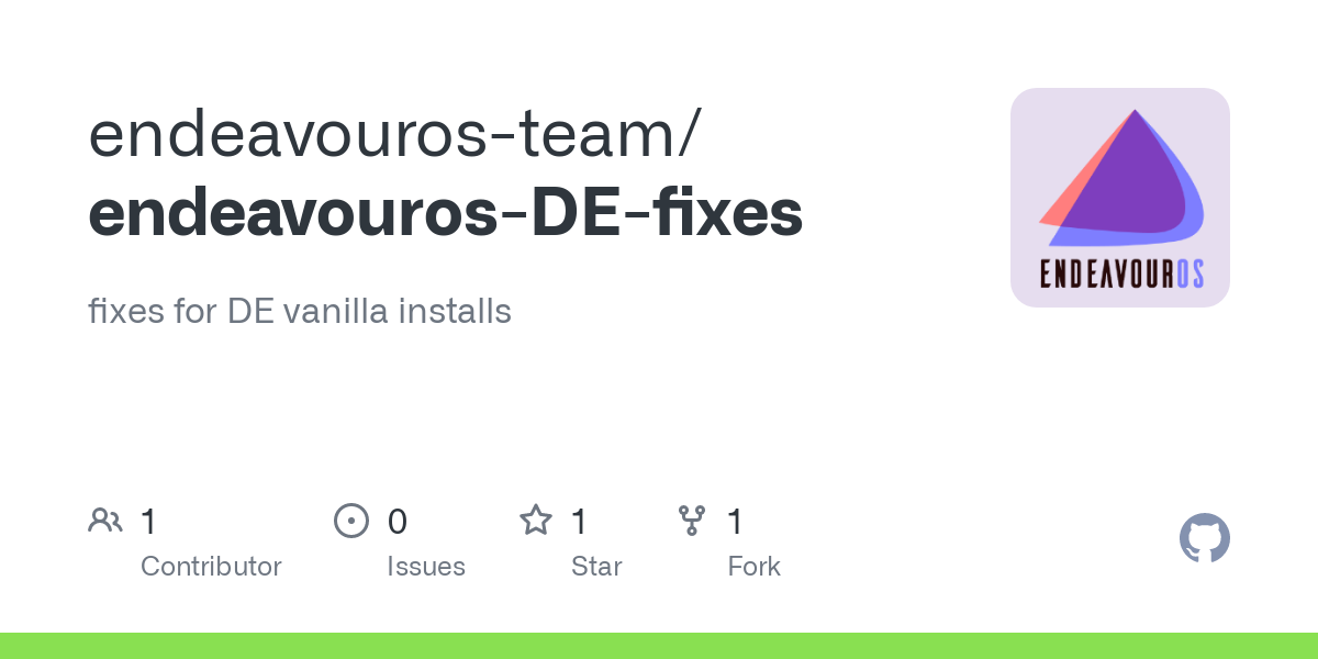

See here and if you want help us find the best way to get it working:
and as @petsam mentioned the best way will be to plasma-desktop package with the fix…

as you can see in the readme:
we try already some stuff but the conclusion is that these are not working nicely caused by the way plasma dynamically set configurations up, and is changing also very fast all the time … what would be a hell to maintain (especial for me not using plasma on a regular base)
