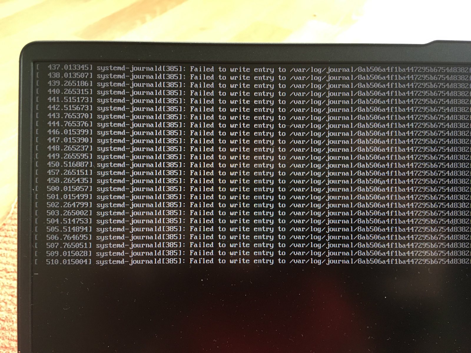

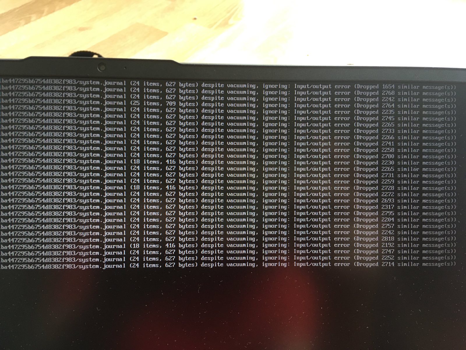

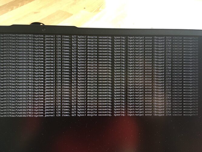

With TTY I can’t use the keyboard, but there is something logging i need to google it, later.
I tried to access TTY again, but i never got these messages again.
Is there a way to keep logs even after a hard reset? I haven’t found anything in the last two hours.
