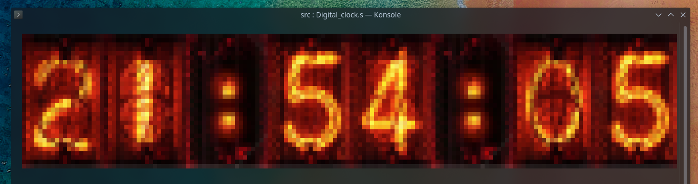

Here is an example of what I came up with (far from perfect, but it gives you the idea of the possibilities):
Nixie tube clock

It looks like this:
nixieclock
The escape sequences were generated using fay, my little experimental terminal image rasteriser. You can use whatever tool you want. It can be a simple ascii art, or a complicated rasterised image. While you don’t have to, you are allowed to modify the script in any way you want (as long as the clock still works). Figure it out, be creative, and make the best looking digital clock in the terminal. :frog:
Here’s my first ASCII entry, which practically have started this thread in a way :upside_down_face:

Real deal to come soon! :partying_face:
Who said Nixie tube?! :sunglasses:
Body is limited to 90000 characters; you entered 135220.
Now…Where can i get the prize? :rofl:
P.S. Script is awesome, as well as fay! :frog:
It’s gorgeous, but so wide! I had to reduce the font size of my terminal to display it correctly.
Fantastic work, nevertheless. It doesn’t even look like something in the terminal…
You should buy bigger screen to watch this! :rofl:
Yeah from the distance looks pretty damn…real
Yeah, I just ordered two 32" monitors (LG-32GN600-B). :rofl:
