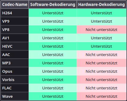

Looks like H256 is not supported in Software mode. But I don’t know why …
OK, set media.rdd-ffmpeg.enabled to true and test again.
Now codec support looks like this.
But videos are still not playing.
Did you restart the browser?
Yes, I did. But the setting was still on false. Switched again to true and now the videos are playing!!!
Looks like it works now. Let me try some other videos …
