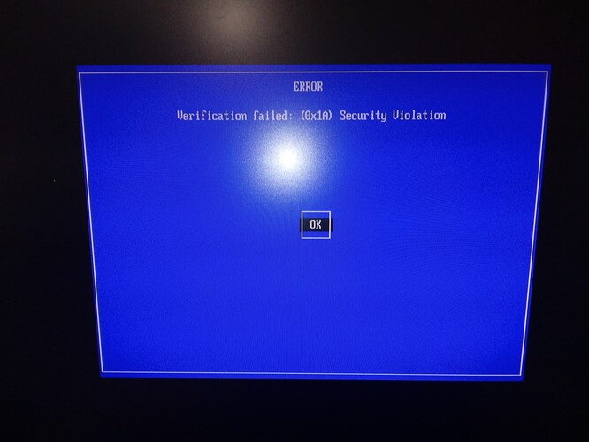

The BIOS shows the liveusb is in UEFI mode
When I created the GPT table, Gparted did not offer /boot/efi mount point, so I added efi after the selected /boot option - the installation failed at the end.
Should the screen be displaying an option for UEFI?
That is booted in BIOS mode, not UEFI.
What can I do if it already says its set to UEFI?
What s the down side of using BIOS mode?
Hit F8 to go to the boot menu and select the UEFI option.
Here is t
he result of choosing UEFI
