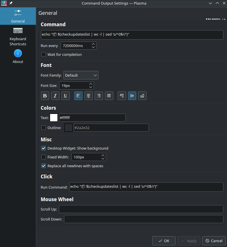

echo "📦 $(checkupdateslist | wc -l | sed 's/^0$//')"
This little line will output an (package) emoji, followed by the number of the packages. If the number is 0, then there won’t be a number displayed. I use this to display available updates on a KDE widget, which runs every now and then. As a former tiling window manager user, I am used to stuff like that.
BTW for anyone interested, I installed a custom widget from https://github.com/Zren/plasma-applet-commandoutput . I use this for several other commands too. The configuration for this is
