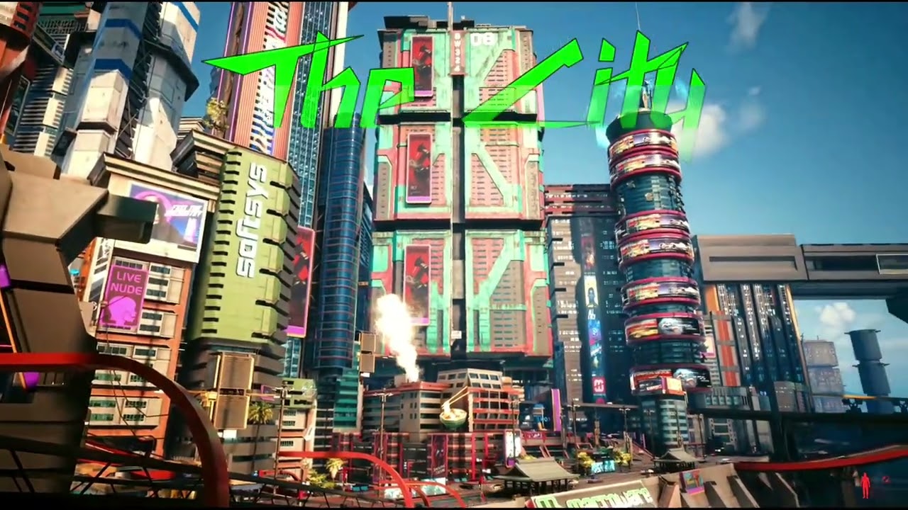

Here’s how it looks (and sounds :hushed:) like when I try to play the video on VLC and Dragon Player:

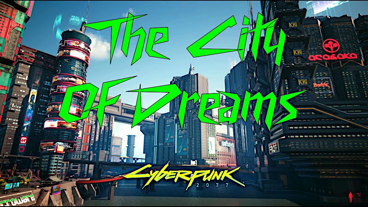

Here’s how it should look and sound:
