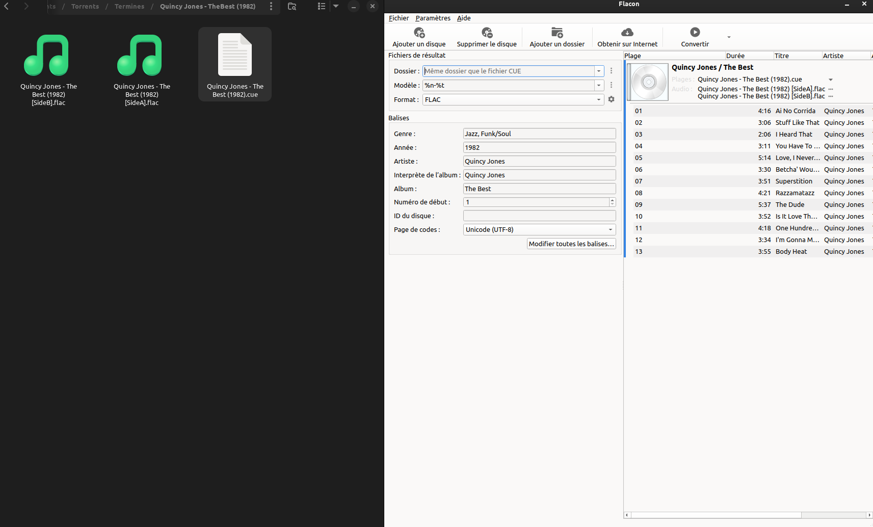

I use Flacon everytime I got to split a big flac/m3u file into multiple files.

This is the perfect situation to use Flacon.
I’m not exactly sure what you are trying to do. As I said I’ve only ripped single tracks from a cd into what ever format i chose.
there are not 13 quincy jones tracks in your music folder. there is only one source file.
flacon sees that one flac source file as 13 songs when you open it? your did you take that one flac source file and make Flacon see the 13 songs inside that single flac file?
if yes, then Nice.

Example:
