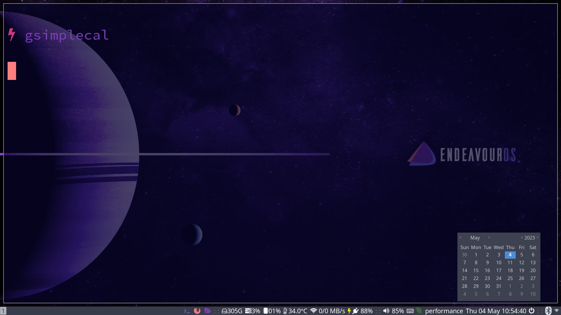

Calendar pop-up
I want ‘gsimplecal’ to pop up when I click on the ‘date’ on the i3bar
I looked through the config directory for i3 but couldn’t figure it out.
Any tips would be greatly appreciated.
Thank you

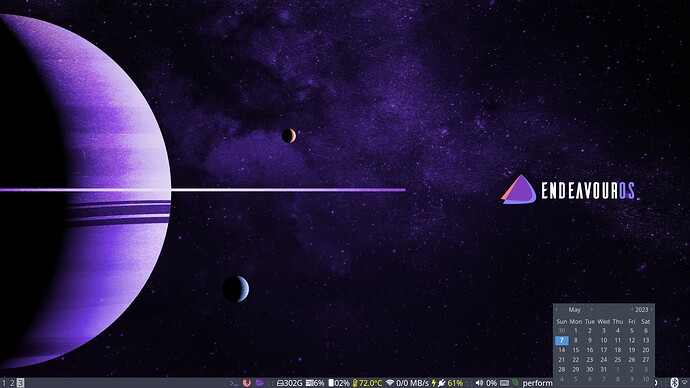

I had to add:
for_window [class="(?i)gsimplecal"] floating enable, move position mouse, move down $height px
from the forum link otherwise it would go below the bar partially

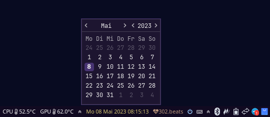

2023-05-08_08-15
no clue why it is not doing this here i have nop extra rule for it in my config

Here’s “my” calendar with adjusted positions from the original:
Summary
#!/usr/bin/env sh
WIDTH=${WIDTH:-200}
HEIGHT=${HEIGHT:-200}
DATEFMT=${DATEFMT:-"+%a %d.%m.%Y %H:%M:%S"}
SHORTFMT=${SHORTFMT:-"+%H:%M:%S"}
OPTIND=1
while getopts ":f:W:H:" opt; do
    case $opt in
        f) DATEFMT="$OPTARG" ;;
        W) WIDTH="$OPTARG" ;;
        H) HEIGHT="$OPTARG" ;;
            echo "Invalid option: -$OPTARG" >&2
            exit 1
            echo "Option -$OPTARG requires an argument." >&2
            exit 1
    esac
done
case "$BLOCK_BUTTON" in
  1|2|3)
	# the position of the upper left corner of the popup
#	posX=$(($BLOCK_X - $WIDTH / 2))
	posX=$(($BLOCK_X - 85))
#	posY=$(($BLOCK_Y - $HEIGHT))
	posY=$(($BLOCK_Y - 260))
	i3-msg -q "exec yad --calendar \
        --width=$WIDTH --height=$HEIGHT \
	    --undecorated --fixed \
	    --close-on-unfocus --no-buttons \
	    --posx=$posX --posy=$posY \
	    > /dev/null"
esac
echo "$LABEL$(date "$DATEFMT")"
echo "$LABEL$(date "$SHORTFMT")"

If you don’t add the line to the i3config, the behavior is a little different:
On used (filled) workspaces it works as before (i.e. --close-on-unfocus) - but when you click on it in an empty workspace, the calendar stays in it’s position (as long as the screen isn’t used by another app, or you quit it on focus with the esc key…
The EnOS i3config already has a line without the title="calendar" string:
for_window [class="Yad"] floating enable.
…I still added the string --title="yad-calendar" to the calendar script.
