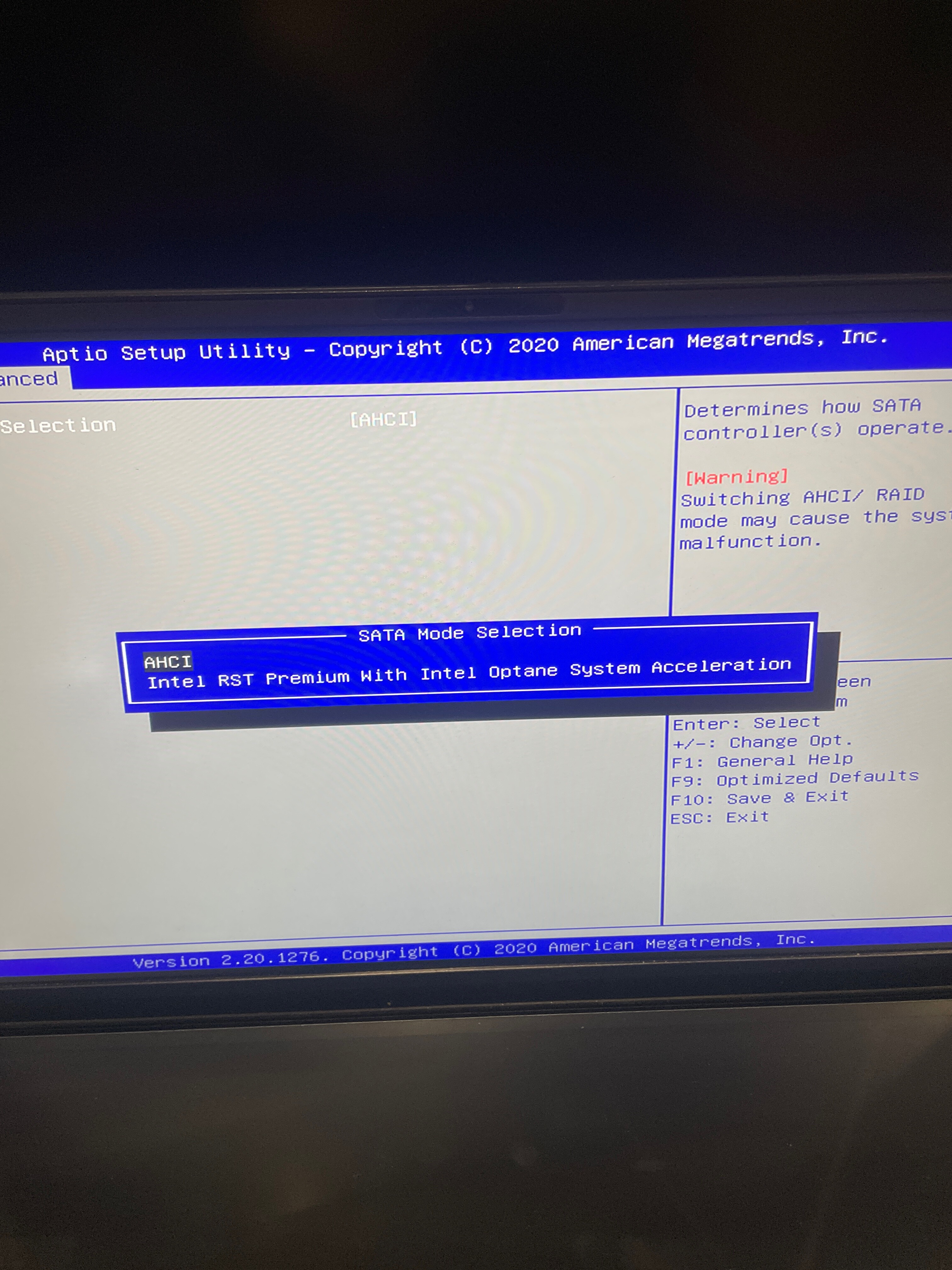

Check the settings in the bios and make sure SATA is set to AHCI not RAID or if it has Intel RST that it is turned off and set to AHCI. You could also try using the following kernel parameters. Not sure if you are using grub or systemd-boot. The kernel parameters are added differently on each.

Ive checked the bios and it is set to AHCI. Ive also tried both those booting parameters sadly. Thank you very much for the reply would you have any other ideas?

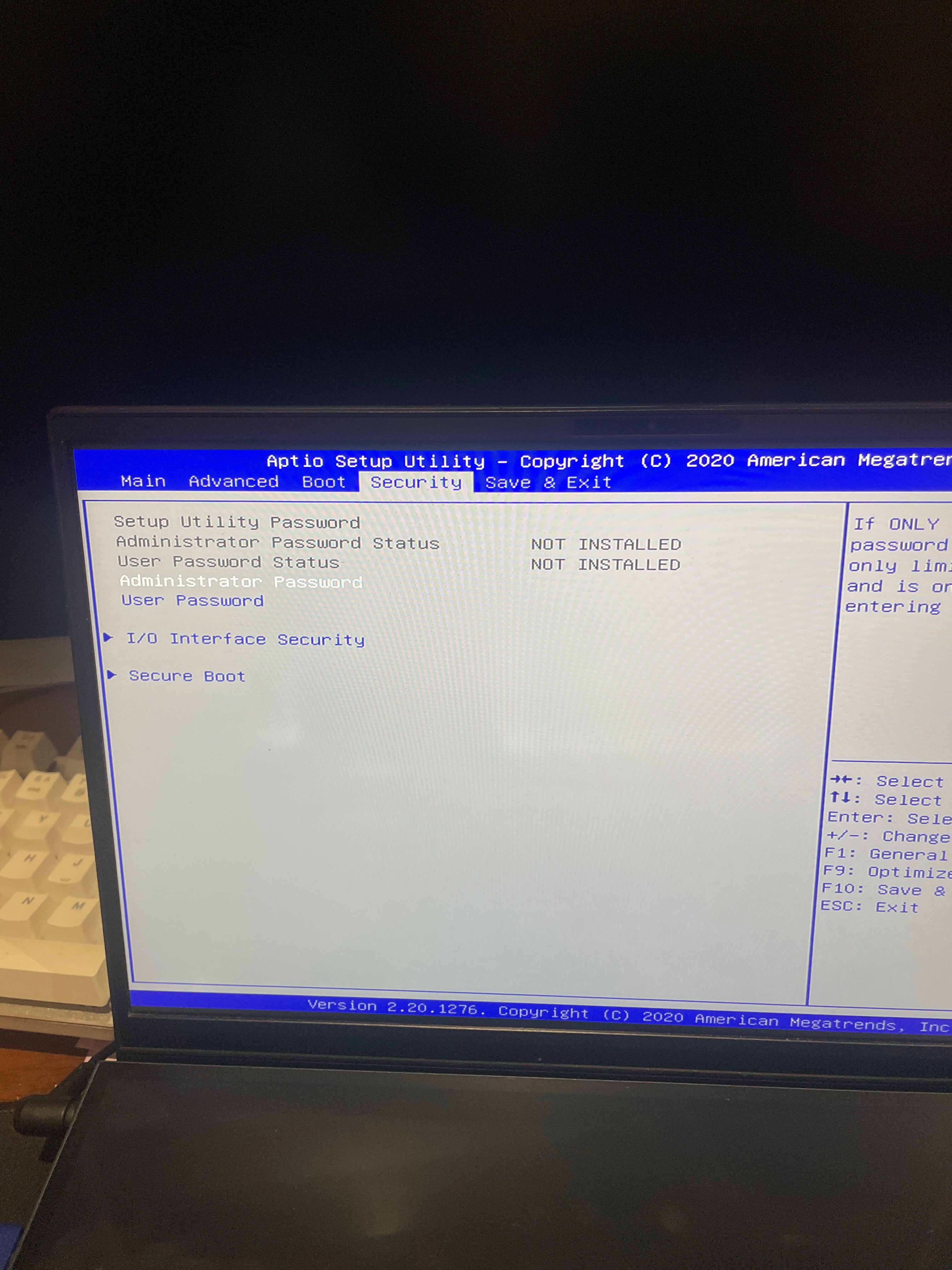

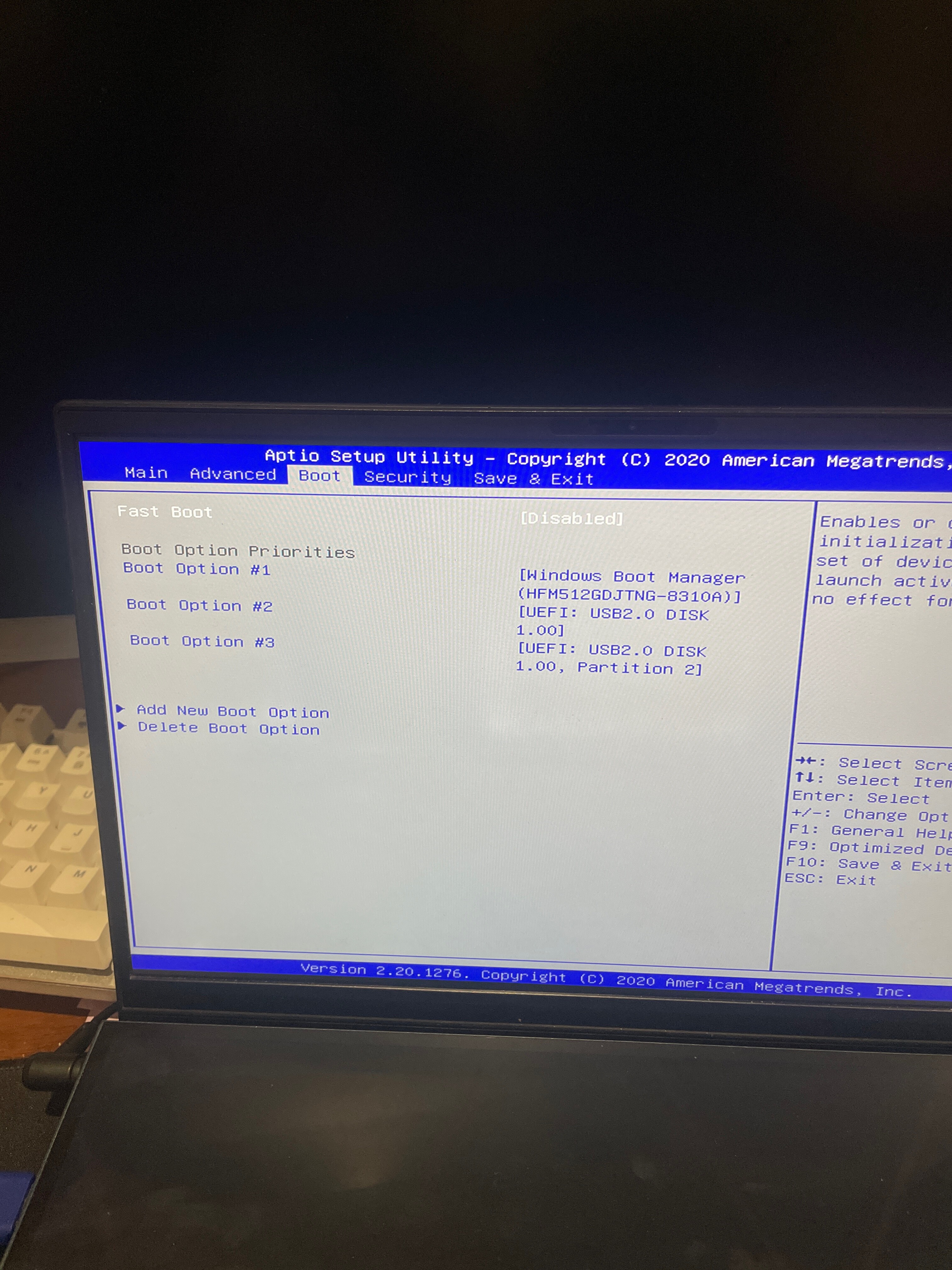

Secure boot and fast boot is off. What about CSM? Is it also turned off?
Edit: I see there are no Bios updates. You have the latest.
Both boots are off and CSM was not an option i believe in the bios, i can upload the pictures though only 5 at a time

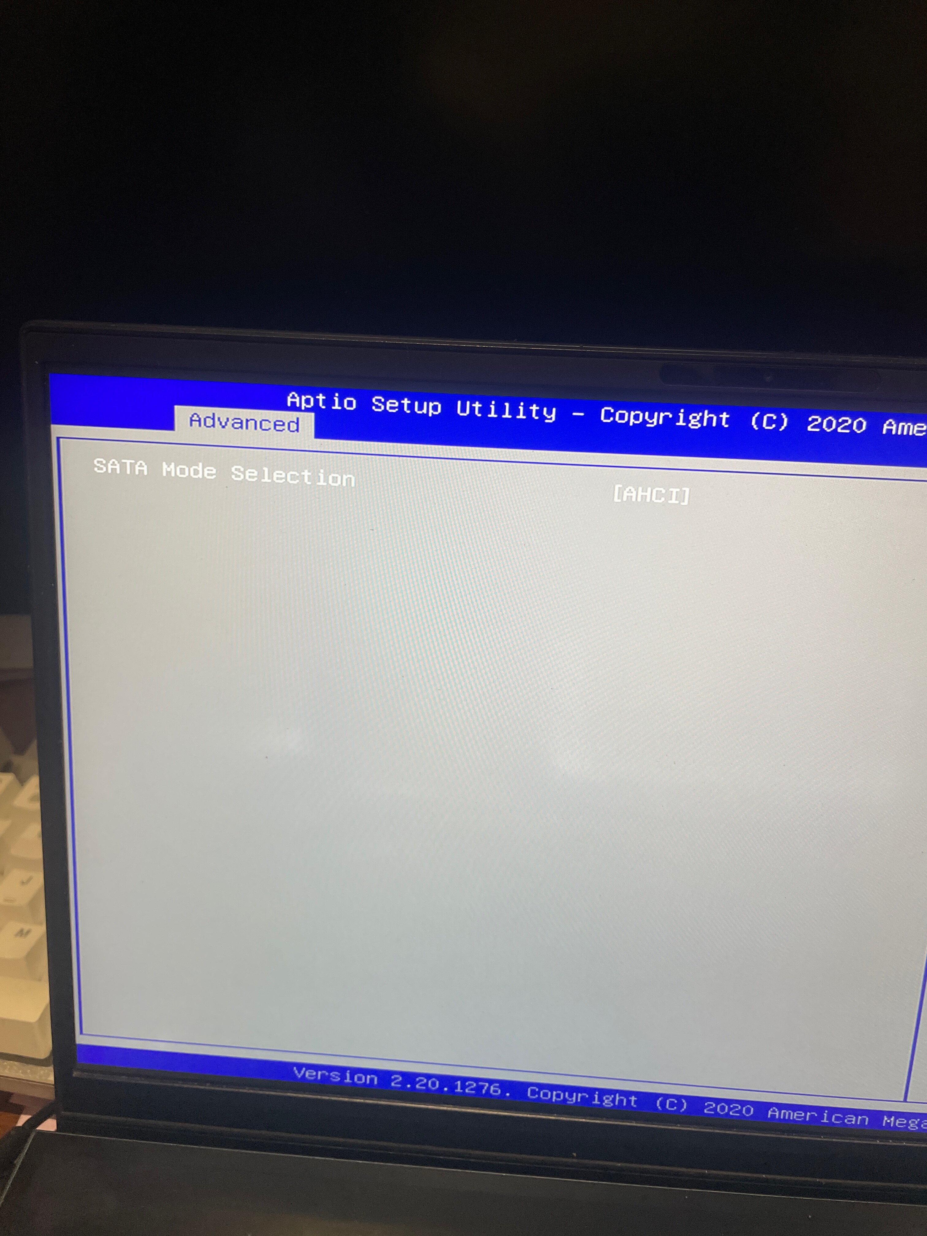

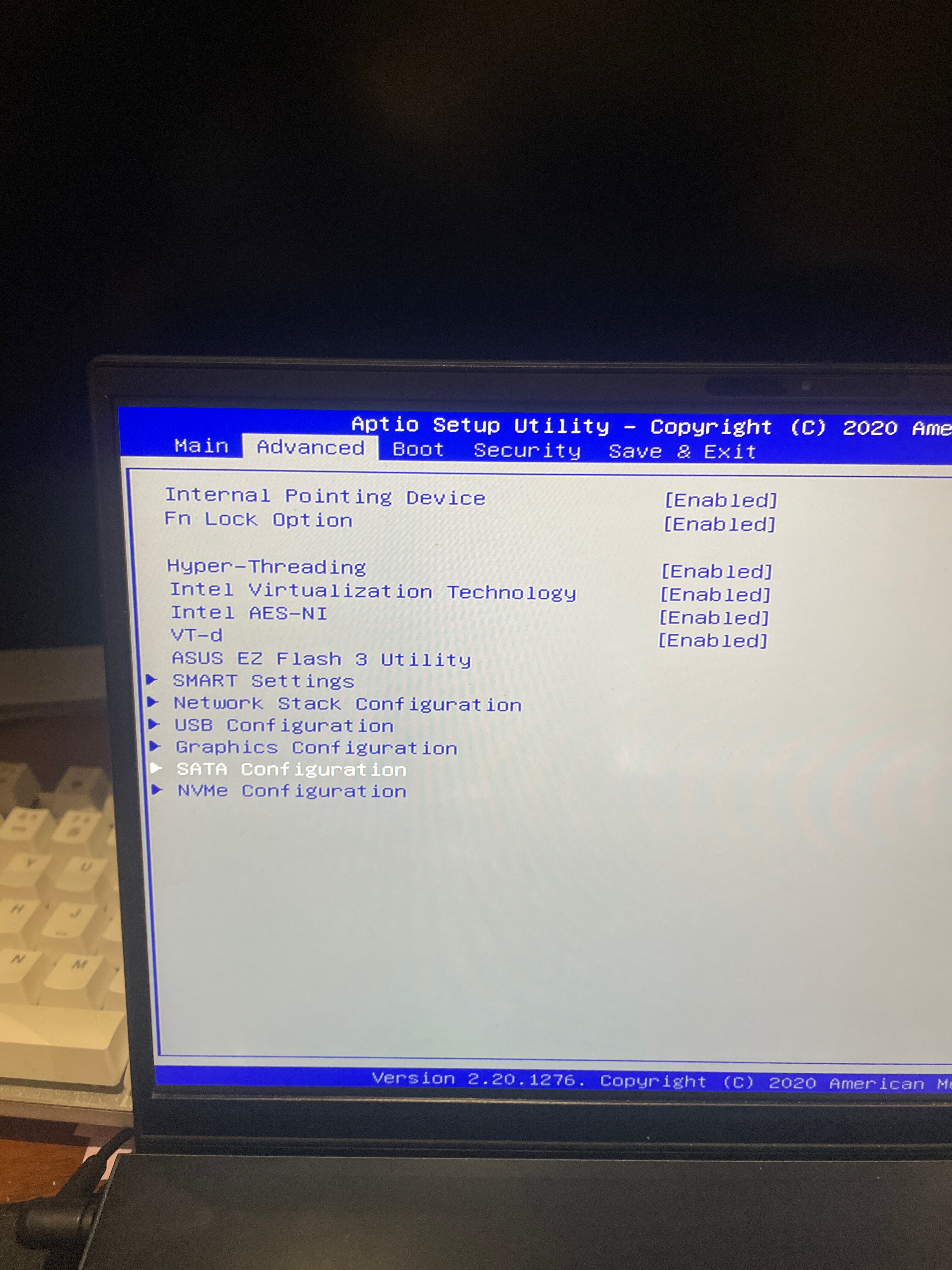

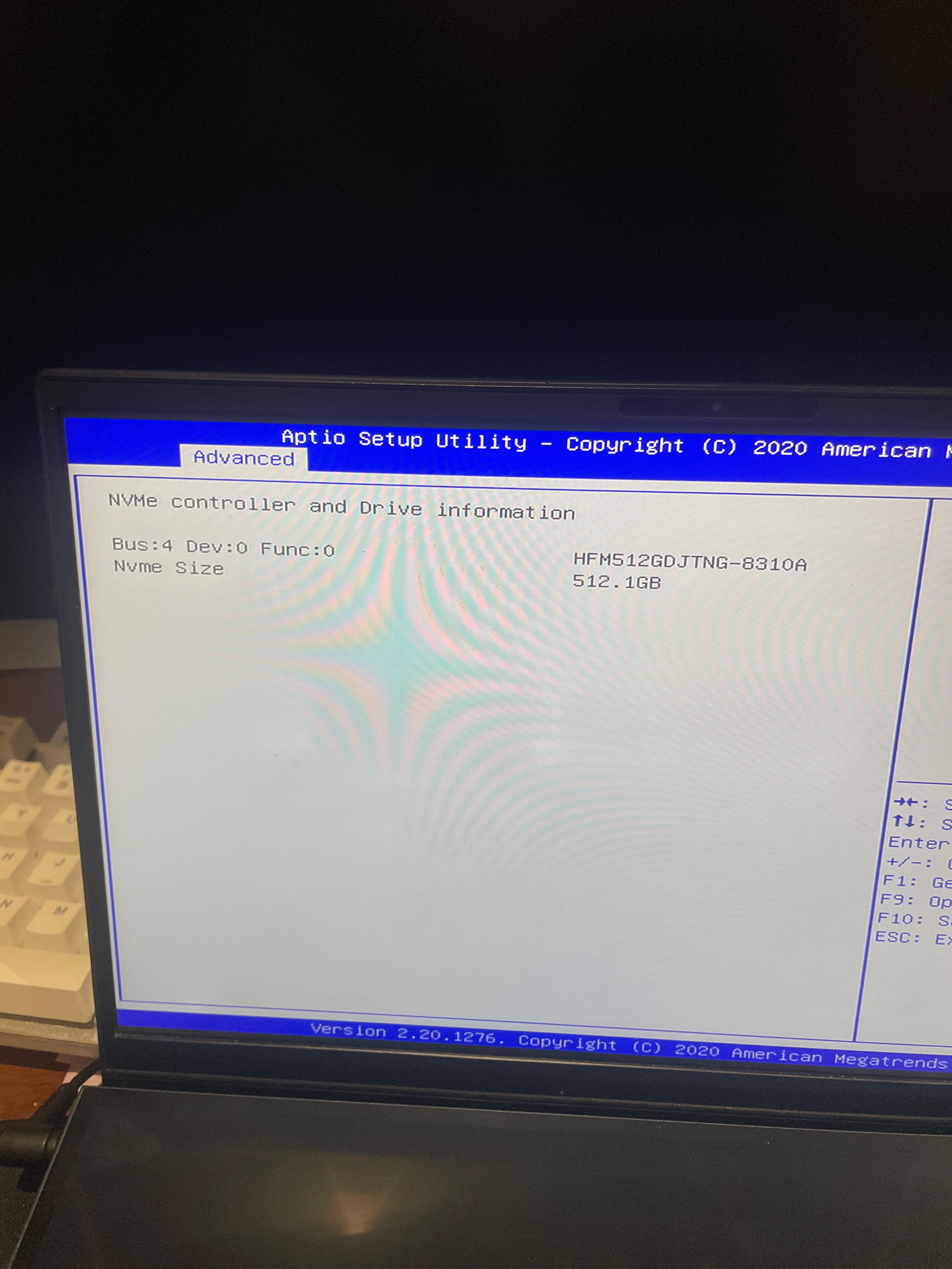

What does it show under nvme configuration?
Edit: Also can i see under sata configuration? Both are under advanced.
Was the SATA drive always on AHCI?
no i changed it, before when it wasnt on AHCI the installer would say there is no available partition to install too. Then after the change he does find a partition though the entire drive appears as 0b and cant be read properly.

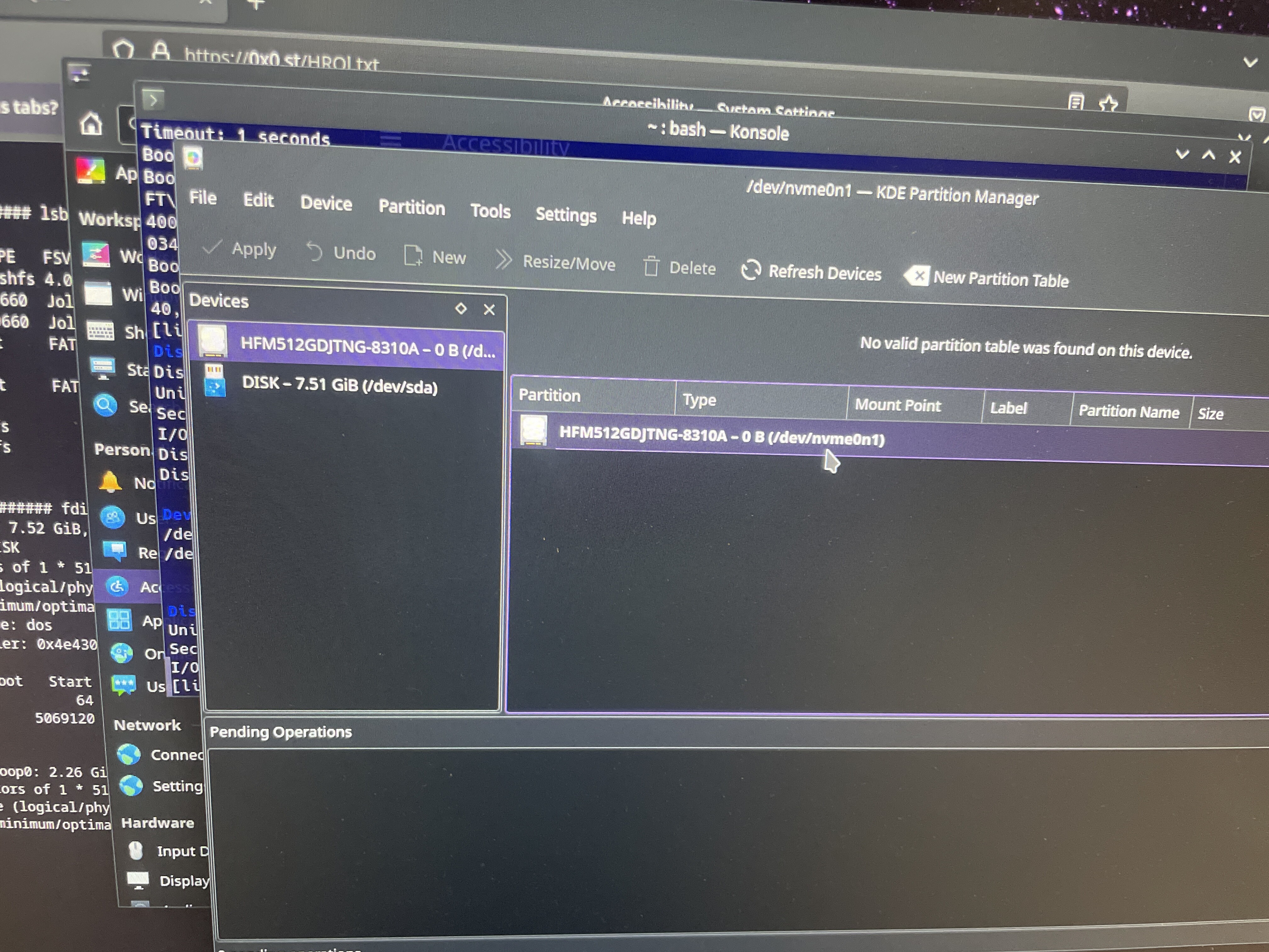

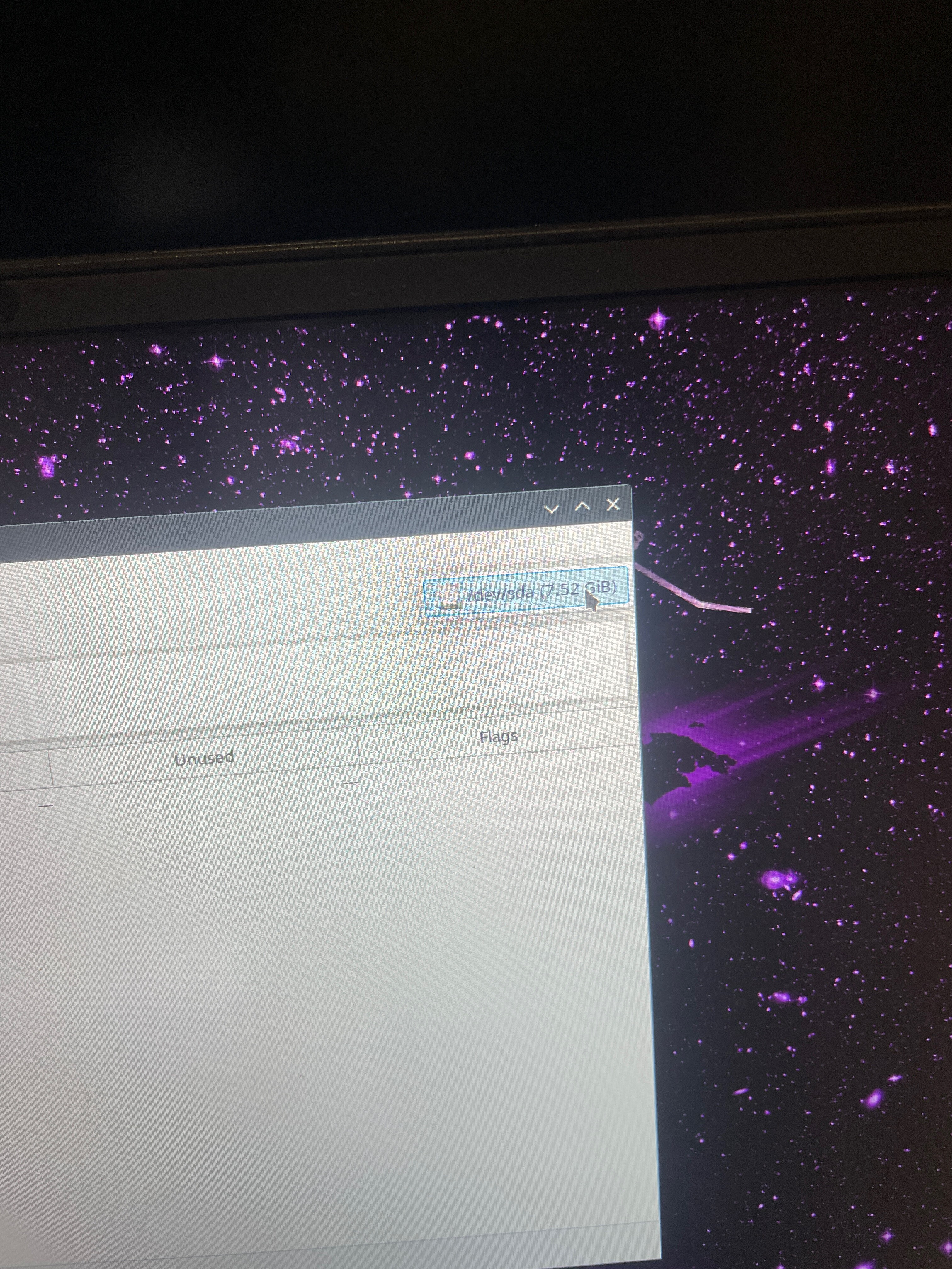

It’s probably related to how the fake raid is setup on the this drive why it doesn’t see it. Are you able to see it with gparted booted on the live ISO. If you have the latest ISO it will have KDE partition manager. You can install gparted and launch it and see what it shows.
both gparted and the partition manager are not able to see it properly
What does it show? Nothing?
it shows the drive as a 0b i will post pictures one sec
Okay it doesn’t recognize any partition table.
