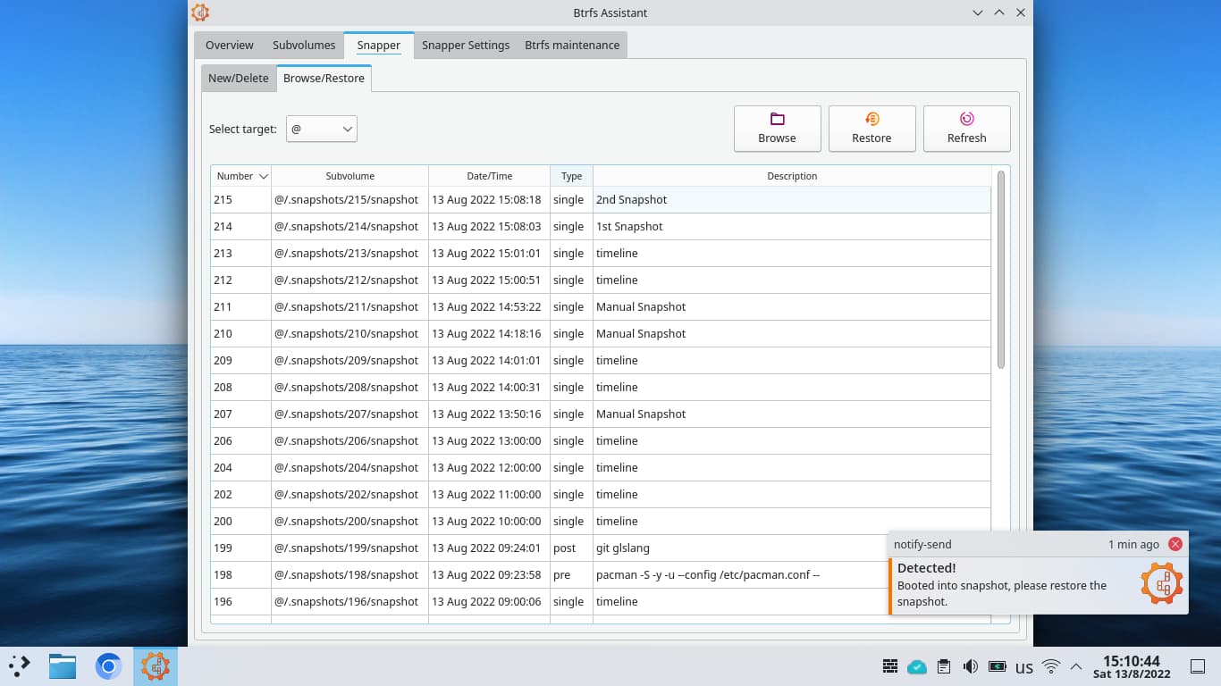

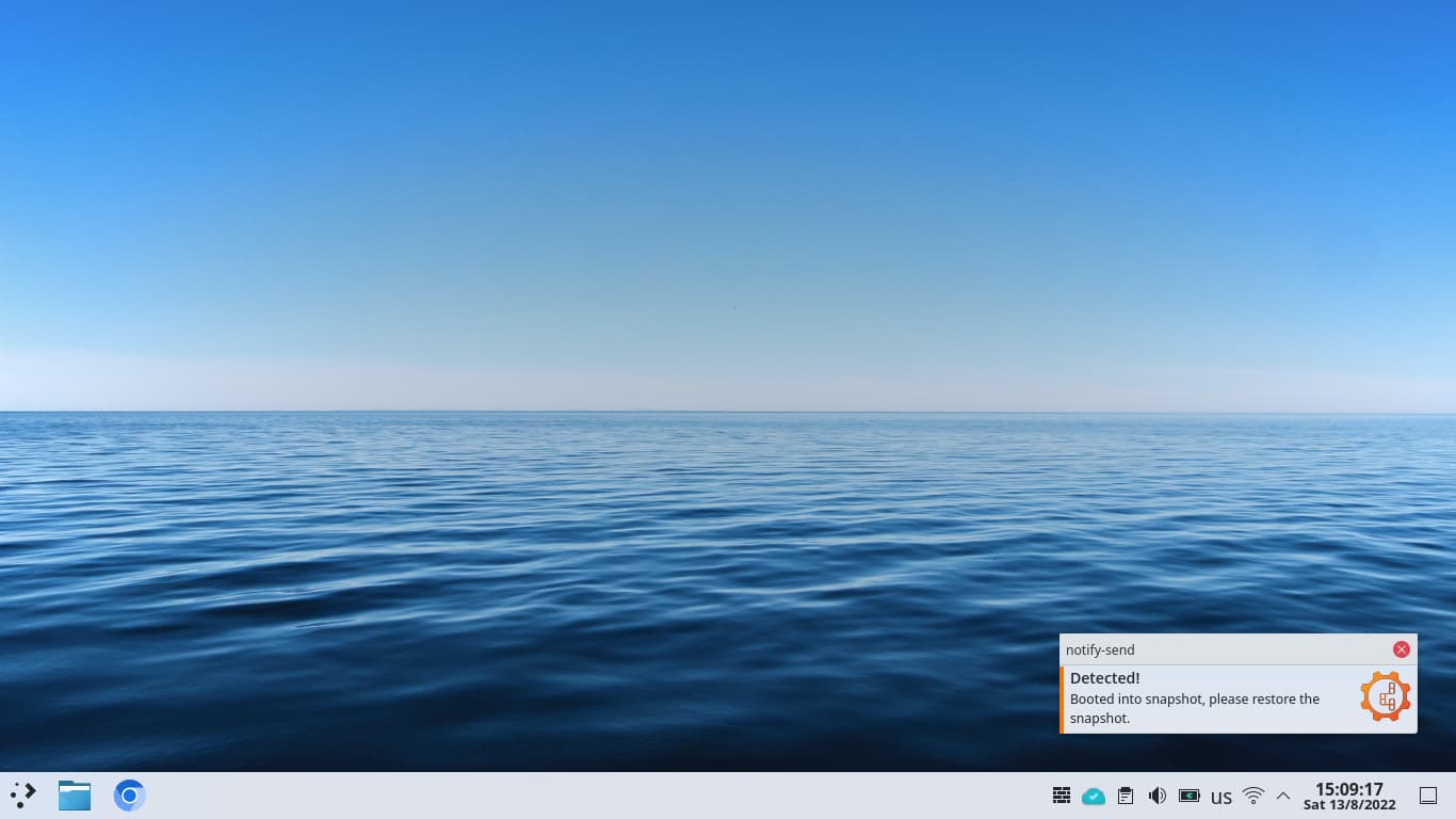

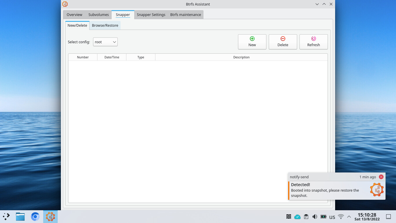

Rebooted normally. then…
A picture is worth more than a thousand words
Seems everything went fine.
1
2
3
Disable grub-btrfs.path again.
Do not forgot to create a new root snapshot after disable grub-btrfs.path
Because you are restoring the latest snapshot but grub-btrfs.path is enabled back. That is why you disable grub-btrfs.path then create a new snapshot that is correct.

So, to clarify, if installing snapper-support, is all of this overlayfs stuff setup then automatically? I thought I knew everything to do once I install for system for real, just want to check. I eventually installed snapper-support, which is why my bootable snapshots worked okay without having manually setup the overlayfs.
Yes, it is done in the .install file. However, it won’t take effect until you run mkinitcpio -P. This happens with every kernel update and also when certain other packages update though so it will happen on it’s own generally speaking.
You can check to see if it installed with grep -qe "^HOOKS=.*grub-btrfs-overlayfs" /etc/mkinitcpio.conf. If that returns anything, the hook was installed.
You can also test booting off a snapshot and running findmnt /. It should show an overlayfs.
