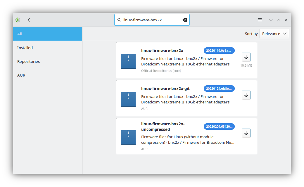

Did you install the linux-firmware-bnx2x package?
@mns6070
As @skaffen said have you installed the linux-firmware-bnx2x
Screenshot_20220212_103343
Edit:
sudo pacman -S linux-firmware-bnx2x
Yes, I tried both the linux-firmware-bnx2x package and the linux-firmware-bnx2x-git package. Both packages are giving me the same result with the error in dmesg. Before I installed linux-firmware-bnx2x package, the card would not work at all, which makes sense. After I added either firmware package for the bnx2x, I only get the one port to work and the other port says it is unplugged even though there is a cable plugged into it and it worked fine in the live ISO. I can try swapping the cables to see if the issue follows my cables, but I highly doubt that would be the issue.
