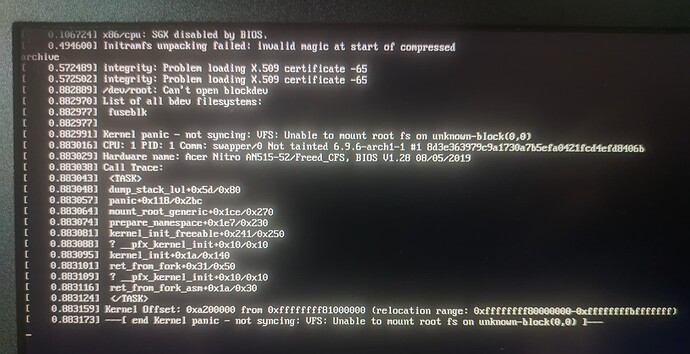

Boot Stuck on "Welcome to EndeavourOS!"
My laptop just shut down abruptly last night.
When I booted up the machine, it was stuck on this screen, and it stays like that forever:
Here are things that I did:
  • Pre-req: I have Secure Boot disabled by default. SATA mode is AHCI.
  • Removed any USB devices as this thread said. No luck.
  • I thought I would boot into my EOS live usb, but it won’t boot either! Same issue!
  • Even tried booting into nomodeset with no luck
  • Fallback image doesn’t work either.
  • But I could boot into my Linux Mint XFCE live usb and access the files
  • I did get an error while booting: integrity: Problem loading X.509 certificate -65
  • So I searched for bad sectors (like this thread said) using badblocks on the main drive; returned none.
  • Tried resetting the bios settings, nope.
What seems to be the cause? I really don’t know. Perhaps it’s the pacman-hooks for my NVIDIA card? Or maybe because I had not updated the system for a while?
Can I chroot into the system using the Mint Live USB and update the system with it? Maybe a kernel issue?
How can I solve this?
Edit:
What happens when booting EOS Live USB:
when booting with NVIDIA Cards option
without the NVIDIA option (UEFI Default)

how do i find out if it’s the nvme ssd that’s causing the issue, as @stareye72 suggested?
try to boot with something else what doesn’t check the nvme and try to mount it could be that the filesystem is corrupt or the nvme has if you mount it and you see the nvme file system then is something else, in the out could not the root mounted that’s why you see only endeauvouros starting.
some kind of BIOS error? I can’t seem to understand
