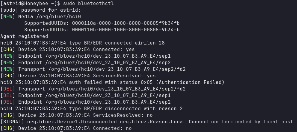

Bluetoothctl logs:

Restarting bluetoothctl, unpairing and pairing, reloading the btusb module and rebooting the laptop don’t work.

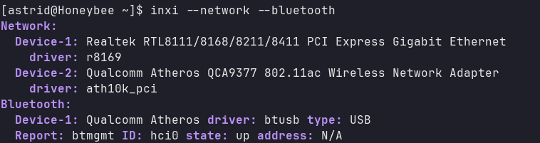

inxi --network --bluetooth
Just to check which Qualcomm Atheros it actually is. As I’ve seen reports that the firmware had to be installed manually.
