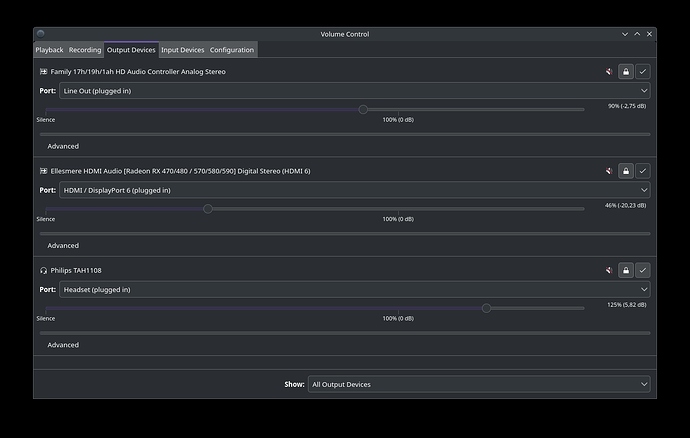

From the paste bin it looks like it’s working but you have no sound. When connected you may have to change the output in the volume control panel. It looks to me that it is paired and connected.

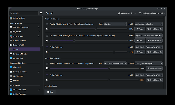

kde system setting sound test has no sound too
yes thats the headphones and it works fine in other devices other than the volume up button being broken

It wasn’t a software issue at all
Connected headset to another PC which the hardware volume works fine and found that it was muted
Unmuted it connected it back to my PC and it works fine
